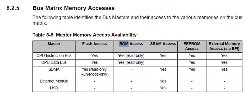

Is there a reason I can't transmit SPI using TIVAuDMA from ROM? Whenever I call SPI_transfer with a ROM pointer for the transmit message, I get a crash and an error.

David,
The DK-TM4C129X requires that the flash be enabled for DMA read. Try adding this code:
// // Set up Flash Access for DMA // HWREG(FLASH_PP) |= FLASH_PP_DFA; HWREG(FLASH_DMASZ) = 0x4000; HWREG(FLASH_DMAST) = 0x0;
