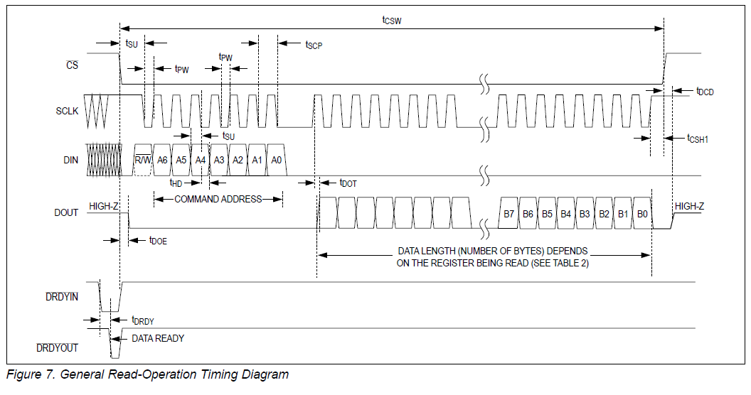

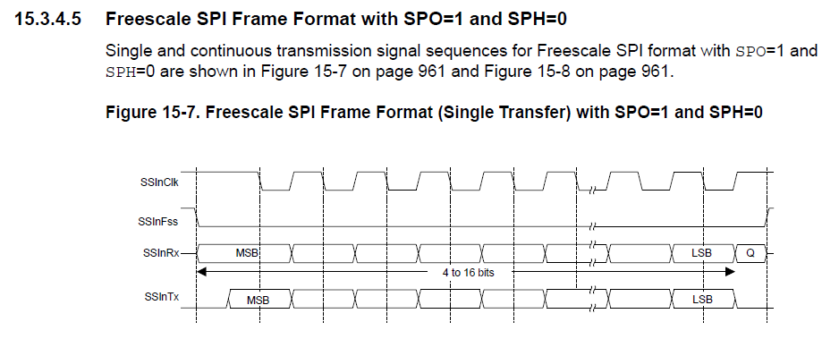

  • Looking at the format of the SPI communications for the Maxim chip I think you need data to come out when CS goes low and then clocked on the falling edge of the clock and shifted on the rising edge.
    The TI description for this format is polarity = 1, phase = 0;
    The driver software refers to that as SSI_FRF_MOTO_MODE_2, not mode 0 as you have in your software.
    The other thing I see is that I think you need to add a dummy SSIDataPut() call in your SPIRead() function. To the SPI, every transaction is both a write and a read. The SSIDataPut() function on the master generates the SPI clocks for both a write and a read. The SSIDataGet() function simply returns the value captured by the last SSIDataPut().

  • Bob,
    You are right about the dummy write to clock out the conversion data.
    I also see below description and this is from the perspective of the ADC. So I think Moto_Mode_0 should be fine.
    A falling edge on SCLK clocks in data at DIN. Data at DOUT changes on the rising edge of SCLK and is valid on the falling edge of SCLK.
    Everything will become obvious if scope is used as suggested by cb1.

    I am not sure format 0 will work. If the Maxim slave does a shift on that first clock rising edge before it clocks in data on the falling edge, both the data read by the slave and that sent to the master will miss the MSb and be left shifted by one. (A scope picture will resolve this.)

    You are absolutely correct. Looking at the MAXIM datasheet again, the SPICLK starts high means the clock polarity is 1 not 0, my bad.
