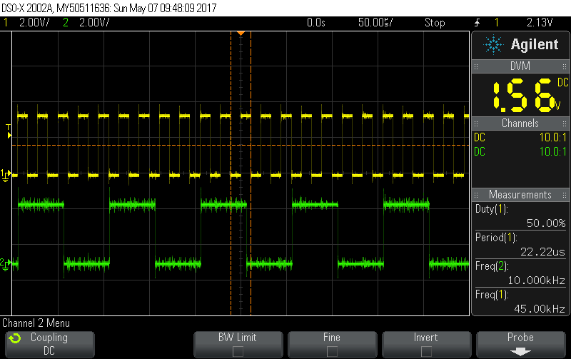

I want to know if it is going to be possible to generate the 5 signals each with their respective period using PWM.
  • While we don't use that MCU - I believe that the individual "PWM Generators" can support up to TWO PWM Outputs - each/either of "user programmable Duty Cycle" - but (both) set to the SAME frequency/period!
    This then requires the (direct) use of "five" such PWM Generators - to yield "five different" PWM frequencies/periods.   (I am 90%+ "sure of this" (Do not bet the farm))
    What to do then?    (assuming that your MCU does not contain 5 independent, PWM Generators)

  • Yet - as poster "succeeded" w/two different PWM Generator Outputs - can his issue (really) be "terminology?"
    Might it - more likely - be, "inability to produce different frequency/period upon the 2 outputs" of a single PWM Generator?
    Again - the duty cycle is individually adjustable - yet the PWM Frequency/Period is (necessarily) SHARED!   (within any, dual channel, PWM Generator)
  • cb1,
    Poster's issue can be terminology, difficulty to configure the outputs, or maybe even just a regular cold - hard to determine from here... But a deeper reading into PWM issues from a previous post won't hurt.
    That particular p/n has "One Pulse Width Modulator (PWM) module, with four PWM generator blocks and a control block, for a total of 8 PWM outputs"
    Since there are 4 generator blocks, he can certainly create 4 different periods. The 5th would need to be created with a timer - not a big deal, just use the timer on PWM mode.
    Those macros used as configuration for the PWM are tricky (as in easy-to-confuse), for they have similar names - so while I can't reproduce/test his code right now, I believe the problem is probably just a bad parameter...

    Like cb1 and Bruno said, each GEN block controls two PWMs and that means they share the same timebase/frequency. You can produce two different duty cycles out of the two PWMs from each GEN block.
    Are you seeing 25% duty cycle out of PWM_OUT_1?
    In your below line you try to set the duty cycle of PWM_OUT_1 to be 50% of the period for GEN_1. Note that PWM_OUT_0 and PWM_OUT_1 shares the same GEN_0. Since the GEN_1 period is half of of GEN_0 and therefore, you should see 25% duty cycle on PWM_OUT_1.

  • Sergio,
    There's nothing "luckier" than cb1 telling me something can't be done when it can.
    Here's your code, enjoy. Sorry I didn't have time to add the timer configuration for the 45KHz signal as well... past 10PM here.
    If you have an EK-TM4C1294 launchpad, the signals will be on headers C1-1, C1-2, C1-4 and C2-3.
    Bruno

  • Greetings cb1, good day fellows,
    I stand corrected, you never said one generator can provide two different frequencies - my apologies. Friday nights certainly don't help an attempt for fast readings, and I got the impression that you had said what poster wanted was not possible!
    As to OP's first request, since it won't hurt to provide a simple example, here's the code which can generate all 5 frequencies he needs:

        PWMGenEnable(PWM0_BASE, PWM_GEN_0);
        PWMGenEnable(PWM0_BASE, PWM_GEN_1);
        PWMGenEnable(PWM0_BASE, PWM_GEN_2);
        PWMGenEnable(PWM0_BASE, PWM_GEN_3);
        PWMOutputState(PWM0_BASE, PWM_OUT_1_BIT | PWM_OUT_2_BIT | PWM_OUT_4_BIT | PWM_OUT_7_BIT, true);
        SysCtlPeripheralEnable(SYSCTL_PERIPH_GPIOD);
        while(!(SysCtlPeripheralReady(SYSCTL_PERIPH_GPIOD)));
        SysCtlPeripheralDisable(SYSCTL_PERIPH_TIMER1);
        SysCtlPeripheralReset(SYSCTL_PERIPH_TIMER1);
        SysCtlPeripheralEnable(SYSCTL_PERIPH_TIMER1);
        while(!(SysCtlPeripheralReady(SYSCTL_PERIPH_TIMER1)));
        GPIOPinTypeTimer(GPIO_PORTD_BASE, GPIO_PIN_3);
        GPIOPinConfigure(GPIO_PD3_T1CCP1);
        TimerConfigure(TIMER1_BASE, TIMER_CFG_SPLIT_PAIR | TIMER_CFG_B_PWM);
        TimerLoadSet(TIMER1_BASE, TIMER_B, systemClock/45000);
        TimerMatchSet(TIMER1_BASE, TIMER_B, systemClock/90000);
        TimerControlLevel(TIMER1_BASE, TIMER_B, false); // Just an example to make the timer PWM active high
        TimerEnable(TIMER1_BASE, TIMER_B);
        while(1)
    On the EK-TM4C1294 launchpad, the signals will be on headers C1-1, C1-2, C1-4, C2-3 (for the PWM signals), plus A1-7 for the 45KHz Timer PWM. And an image showing two of the channels below, one at 10KHz and the other at 45KHz - no more channels available on this scope and I won't set up a logic anaylzer today:
    Bruno

  • Further to the previous reply: yes, I agree that it is "less consuming" to use TCCP's for these simple PWM signals rather than the PWM hardware itself.
    Is this reading correct, as for which one to choose in a project?
    - PWM hardwares have special features such as direct synchronization, guaranteed dead bands, and easy to obtain opposite signals from one single generator - they have features specially focused for motion control. There is only 1 block with 4 generators in most part numbers - some have none, a few (if any) have two.
    - Timers are simple multi-purpose beasts, and as the codes on this post prove, can also generate square pulses very easily. They are much more abundant in TM4C's, and it is easier to find a TCCP available than it is to find a PWM pin.
