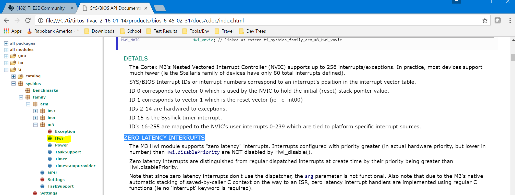

  • Thank you.. Can you point to a specific code example available? Say i use a timer to trigger a zero latency interrupt tp toggle on ek tn4c1294xl on board led..
    Your answer was informative and correct but i need a little more help in termsof code and link to cdoc to run and test this.
  • We don't have a code example in the product. You can get to the cdoc via the Documentation_Overview.html in the docs directory of the installed product. Then search for "TI-RTOS Kernel Runtime APIs and Configuration (cdoc)". You can also use dev.ti.com/.../ to see the documentation on the web. You need to navigate to ti->sysbios->family->arm->m3->Hwi.
