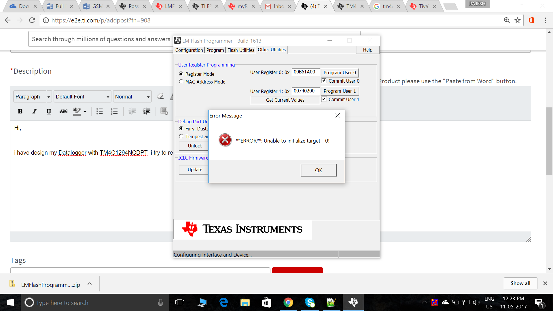

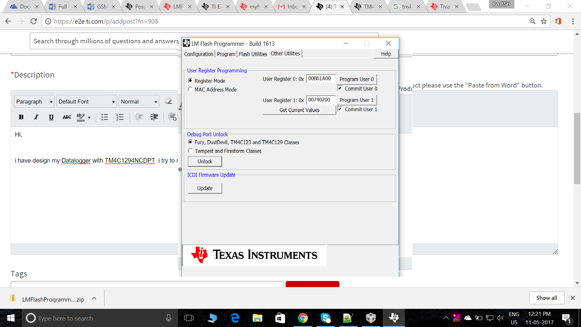

i have  my Datalogger with TM4C1294NCDPT  i try to register user register 0 and 1 i am getting following error ,i read some ti forum answers i tried to unlock device its erased entire flash inside .even i cant able to load blink programe also .
what the steps to configure mac for my prototype board .
now i lost my internal flash also

    Sorry your post has been missed for a few days.
    I'm not clear with your question. Are you saying that you went through the unlock sequence. As the result of the unlock sequence you lost the MAC address and you are asking how to re-program the MAC address?
    You can select the MAC Address Mode and give your MAC address. If you are using the LaunchPad then there is a sticker in the backside of the LP board that shows the MAC address. You just program that MAC address again.
  • Thanks for reply i configured that mac address that problem was finished.
