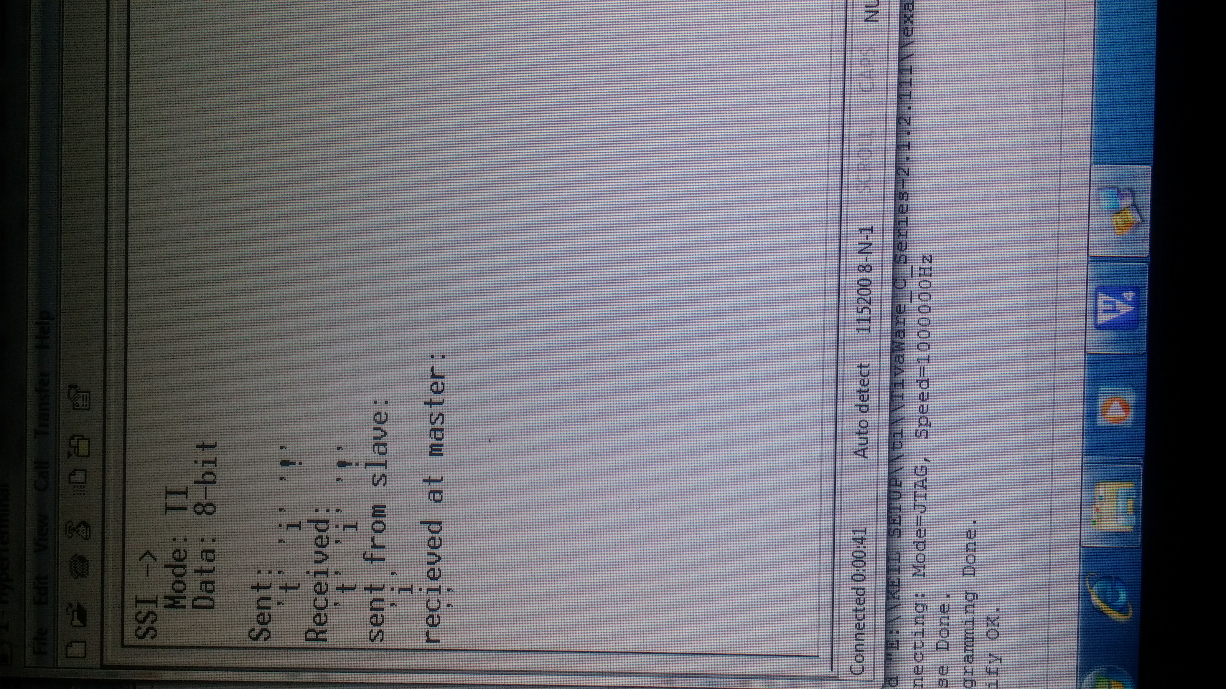

For ssi communication between two ports i am facing communication problem from slave to master end. I am using ssi0 and ssi2 where ssi0 is master and ssi2 is slave.From master to slave, communication is working fine but from slave to master my sent byte is not being received. in debug mode, i have seen that it shows 0x0000 instead of correct data. Please help.

//*********Output is as below***********//
  • In line 263, shouldn't you be waiting on SSI0 to finish, not SSI2? Then I don't think you want the call to SSIDataGetNonBlocking in lines 272 through 274 in a while loop. That will empty the receive FIFO of SSI2. (Perhaps you should put that code up by line 225-226 to make sure the receive FIFO of SSI2 is empty before you start the transmission on SSI0.) Then if you want to read the SSI2 receive FIFO in a for loop (lines 279-298) use SSIDataGet() instead of SSIDataGetNonBlocking .
    In line 295 you are printing the data you sent instead of what you received even though you titled it "Received:". You actually never loaded the SSI2 TX FIFO so SSI0 will not receive valid data. On the SSI both master and slave are both transmitting and receiving at the same time (full duplex). Load the slave FIFO first (SSIDataPut(SSI2_BASE, data), then load the master data (SSIDataPut(SSI0_BASE, data). Loading the master TX FIFO starts the transmission. When the master has finished transmitting, you can read the data from the master and slave FIFOs.
