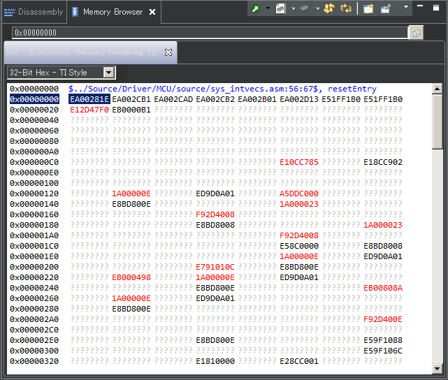

But abort occurred when we operated our application which changed to operate on RAM.
Timing of abort is Calling  __TI_auto_init()→run_binit()→copy_in()→memset().
I checked the memory browser after calling _coreEnableFlashEcc_ ().
It shows many "????????"
I think that it means uncorrectable Ecc Error.
Is this Why?

  • Hello Takashi-san,
    Did you copy the object files to RAM before or after you enable ECC? The multiple locations with ??????? indicates that the debugger is unable to read those locations which is most likely due to uninitialized ECC memory in RAM. If you enable RAM ECC before memory init and copy to RAM, the ECC values would be updated to correspond to your object code.

  • Additional Information.
    I Changed the way of generating ECC.
    When Enable Auto ECC Generation Setting in CCS, It seems to work fine.
    Why? I need to write special Description in Linker command file?
    The only explanation I can think is that there was an ECC issue associated with reading and copying the object code into RAM. By enabling the auto ECC generation, you have, most likely, resolved the issue. Perhaps it is related to an unprogrammed area that wasn't getting an ECC value programmed or reading beyond the end of the original object file, etc. If you are using the auto ECC generation, there should be no need for special descriptions in the Linker command file.
