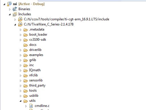

     Normally in CCS if you press ctrl key and left-click on the #include "utils/uartstdio.h" it will open the uartstdio.h file for you. If you do that does it find the uartstdio.h file? In the project directory, if you go to <your project>->Includes->C:ti/TivaWare_C_Series-2.1.4.178->utils do you see the uartstdio.h file?
      Normally I have seen other posters with the problem during linking when the uartstdio.obj is not found/compiled. If this is the case you need to make sure the uartdtdio.c is either linked or copied to your project directory.

    Working on Mac, the right-click will present a popup menu. Among the options is Open Declaration (F3) - I assume this is what you're referring to? According to that approach, most of my includes were not find-able. ( This seems odd, as the compiler provided no errors hinting at this... )
    Anyway, the key bit was: including both specific path in my #includes:
    .../SW-TM4C-2.1.4.178/examples/boards/ek-tm4c129exl  -- to the board-specific stuff  - as well as -
    .../SW-TM4C-2.1.4.178  -- to the entire TivaWare archive
    'drivers' are located in the first.
    'driverlib', 'inc', 'utils' and others are in the second, of course.
    and explicitly copied uartstdio.c into the project, per your suggestion.
