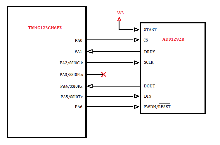

Hello.
I have the following problem. The code I wrote for communicating between TM4C123GH6PZ and ADS1292R via SPI doesn't work. I am trying to read the ECG and respiration data from the ADS1292R (slave) and then send it through the UART, but I'm getting only zeroes, and not the actual data. I also tried to read the WHOAMI (ID) pin, but it reads as 0. I tried measuring the signals with a logic analyzer, but the results are not what I expected. For starters, the clock's frequency is 50kHz (even though in the code I've set the frequency to 1MHz) and the CS pin doesn't go down every time it should. Also, when I set the CPOL = 0 and CPHA = 1 in the settings, Saleae reports an error "The initial (idle) state of the CLK line does not match the settings.", but when I set CPOL = 1 it reades '255' on both transmitter and reciever, even though it's not supposed to. In ADS1292R datasheet it says the correct settings are CPOL = 0 and CPHA = 1, so I set SSI_FRF_MOTO_MODE_1 in SSI configuration. I am using Arduino Library for ADS1292R Shield/Breakout which I adapted so it fits my TM4C uC.
All this confuses me since I'm new to working with microcontrollers and I would really appreciate some help. I'm not even sure if the problem is with the software or hardware. In the attachment I put the whole project (folder: 'project'), the results from Saleae (folder: 'SALEAE SAMPLES'), the scheme of connecting the pins I used (folder: 'Scheme') and the Arduino Library for ADS1292R Shield/Breakout (folder: 'arduino_library').

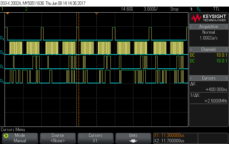

  • Thank you both for a fast reply.
    Today I tried running the code on a TM4C123G LaunchPad™ Evaluation Kit (which is not connected to the ADS1292R) for debbuging purposes and measuring with a logic analyzer to see if I'm sending the data correctly from the master (the pins on the other board are not easy to probe with the analyser). After some tinkering with the code, this is an example of what I'm sending through the MOSI line: http://imgur.com/W59EhCe
    Is it supposed to look like that? It seems okay to me, the data on the MOSI line matches what I'm sending in the code and the clock is fine and showing 1MHz on the LaunchPad.
    Tommorow I'll try to run the 'fixed' code on the other board and get back to you.
    Cheers!
    Laura
  • Laura,
    That's "kind of" how it is supposed to look like. It's just great to work with proper tools, ain't?
    Do you have an additional channel on your Saleae? Looking at the CS line is also important.
    I see some MOSI activity before the clock, that's suspicious.
    Here's a 4 channel capture for one particular sensor, it might help you.
    Bruno
  • Bruno,
    I was looking at the CS line as well, it's on channel 3:
    Just like the last example, his was measured on the Tiva LaunchPad which is not connected to the slave. There's MOSI activity before and after the clock, if that's a problem how do I fix it? It doesn't seem to bother Saleae since it deciphers the sent data correctly, I am really am trying to send 0xFF 9 times (as dummy data). Could those be start and stop bits? In the example you've sent me there also seems to be some activity on D2 channel while clock is inactive.
    This is the function I use to get data from the ADS1292R:

  • Bruno,
    this is my SSI init function:
    void SSI0_init(){
    	SysCtlPeripheralEnable(SYSCTL_PERIPH_SSI0);
    	SysCtlPeripheralEnable(SYSCTL_PERIPH_GPIOA);
    	configureGPIOA(); // sets the port A pins 0 and 1 to non-alternate function
    	GPIOPinConfigure(GPIO_PA2_SSI0CLK);
    	GPIOPinConfigure(GPIO_PA3_SSI0FSS);
    	GPIOPinConfigure(GPIO_PA4_SSI0RX);
    	GPIOPinConfigure(GPIO_PA5_SSI0TX);
    	GPIOPinTypeSSI(GPIO_PORTA_BASE,GPIO_PIN_5|GPIO_PIN_4|GPIO_PIN_3|GPIO_PIN_2);
    	GPIOPinTypeGPIOInput(GPIO_PORTA_BASE, GPIO_PIN_1);	//DRDY
    	GPIOPinTypeGPIOOutput(GPIO_PORTA_BASE, GPIO_PIN_0);	//CS
    	GPIOPinTypeGPIOOutput(GPIO_PORTA_BASE, GPIO_PIN_6);	//PWDN
    	// CPOL = 0, CPHA = 1 --> SSI_FRF_MOTO_MODE_1
    	SSIConfigSetExpClk(SSI0_BASE, SysCtlClockGet(), SSI_FRF_MOTO_MODE_1, SSI_MODE_MASTER, 1000000, 8);
    	SSIEnable(SSI0_BASE);
    And i think that part is okay. In the datasheet it says the SPI mode is SSI_FRF_MOTO_MODE_1, and the CS is active when low. I've set SSI_FRF_MOTO_MODE_1 both in program and in Saleae options.
    The sensor sends 3 "words" in a row, each is 24 bits long, so I'm reading 8 bits 9 times and then later reassembling those to get proper data.
    Laura

    In the folder I put some screenshots of the Saleae files (but the MISO line is irrelevant since it's measured on the TiVa LaunchPad and not on the real board).

    Just so you know, you can still use PA3 to connect to the CS - we just recommend it to be configured as GPIO instead of letting the SSI hardware take care. That would be more practical in case you later actually want to try to use the CS pin automatically controlled.
    The saleae signals now look reasonable. The mode for the sensor is really MODE_1, BUT your file main2.c parameter is MODE_0.
    The frequency is correct at 1MHz (just double check, measure the frequency on the analyzer, for the SSI dividers sometime generate faster values than what is passed on the Tivaware parameter.
    Do the values you see on saleae MOSI match what you are actually sending on the Tiva?
    The writing/reading sequence on your while loop is confused... You are not reading everything.
    Look and compare the code I posted on an earlier message: you are using your SSI as 8 bits, so everytime you place 8 bits out, there will be 8 bits on the receive buffer which you must read (and later reconstruct). And instead of a blind wait loop, just check until the SPI bits are all sent, then read what came back.
    Cheers
    Bruno

    The FSS pin is not physically connected to anything on the board and the GPIO_PORTA_PIN0 is physically connected to the CS, as shown in the scheme:
    That's why I don't use the FSS, but thanks for the tip.

    The values I'm seeing on the MOSI line match what I'm trying to send.
    This is the piece of information that I've been missing. I thought that's just some programming practice, reading useless data even though your goal is just to send it, not a must. I will fix that now.
    Thanks a lot for your time! Hope it will work now, I'll get back to you either way.
