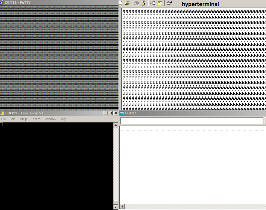

Hello All,
I was trying to implement a circular buffer using UART. In the testing stage I simply output an ASCII character('a') inside infinite while loop. It was working fine till I disconnected the power supply and turned it ON again(about 30 secs delay). At this point of time some random character started appearing on the screen instead of ASCII 'a'. We need to press reset switch every time after each power ON cycle to print the characters properly.  Instead of using Direct Register Access program model I tested with some Tivaware examples. It didn't solve the problem. An interesting thing to be noted here is that it happens only with 9600 baudrate. When I changed the baudrate from 9600 to 115200, the code started printing characters as expected (It only created problem at the very first power on cycle which is acceptable). From PC side I am configuring it for 9600 8-N-1. I tried PuTTy, teraterm, hyperterminal and arduino serial monitor with no success (teratern even refused to print those characters). When I repeated the experiment with Arduino IDE and Arduino UNO, it worked perfectly fine with all softwares. This behavior is so random in nature ie if I don't give more than a couple of seconds delay between power ON and OFF the problem doesn't come. I have discussed a similar problem in the following thread but at that point of time putting a delay between UART init and infinite while loop solved the problem.
https://e2e.ti.com/support/microcontrollers/tiva_arm/f/908/t/534352
Some screen shots are attached for your reference.
Any help would be greatly appreciated

    This seems to be related to whatever you are using to convert TTL uart to RS232 level. How do you connect your TM4C to the PC? Maybe the power up sequence is such that the device converting is not able to detect the speed?

    Interesting... do you have a logic analyzer available? You could see the actual UART transmitted signals by probing that TX0 empty hole on the Launchpad. If you don't, you can divert that signal out to an external RS232 converter to see the bytes.
    I suspect that the TM4C is actually sending the proper bytes, and that the problem lies on the ICDI MCU... The above would confirm that.
    If so, maybe the "ICDI MCU" needs more time to settle after a power reset? You could be sending the bytes too soon, and for some reason it detects a wrong transmission speed??? Just guessing here...

  • It is quite possible for a UART to detect a character start at mid character. If the characters are formed in a particular way and sent close enough together then it can continuously mis-sync.
    See if inserting a small delay makes a difference. Upping the stop bits may help as well.

    The link is working. I think there is some problem with my browser/PC. I did the following things as suggested by you and finally succeeded
    1) Updated the firmware - No Success
    2) Changed the stop bits to 2 - No success
    3) Diverted the signal out to an external RS232 converter - Success
    I think there are some timing/power up issues with ICDI hardware. Anyways I will test it further.

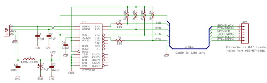

    Sorry for the late reply. I didn't use any logic analyzer because a 3.3V FTDI cable from sparkfun, when connected between the exposed TxD pad and the PC, solved the issue.
  • Thanks for the feedback, Supreeth.
    Let the record show that a "FTDI cable" is a TTL UART to USB converter:
    Whatever the problem was, it WAS in the ICDI chip. I still believe it was running out of sync during startup, despite fellow's belief that thousands having used the launchpad ICDI for UART would have raised the flag before.
