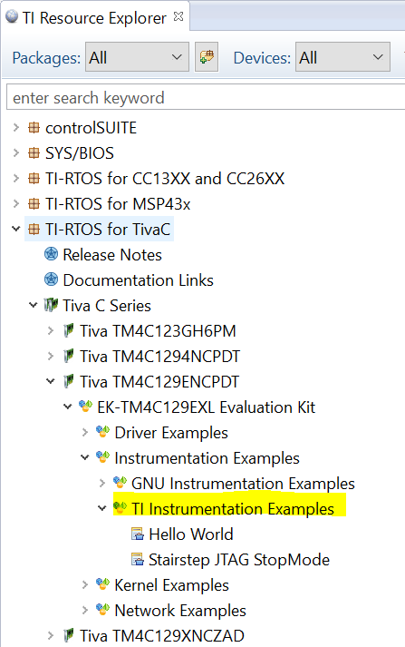

I am trying to use the "Printf and error logs" feature in RTOS analyzer but, in the "Analysis configuration" window get the "Select a valid UIA configuration file" error. The problem is that I:
a) do not know where this file would be if UIA were properly installed and
b) do not know if UIA is even properly installed.
In the Project Properties -> General -> RTSC tab I do not see anything other than "TI-RTOS for TIVAC v. 2.16.0.08" and "TM4C ARMA Cortex M4F MCU. "
I separately downloaded and extracted the UIA folder to the same location as the the TI-RTOS TivaC folder ("C:\ti\tirex-content") but still do not see it in RTSC tab. Where should the UIA folder be located so that it is visible in the RTSC tab? And, after it's visible here, will the UIA configuration file automatically be loaded into the RTOS analyzer?
