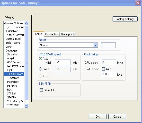

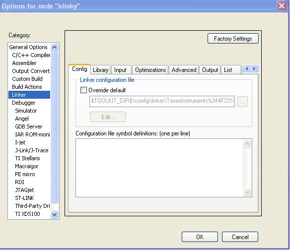

  • My friend - as promised - find here the "Key Screen Shots" showing our set-up of IAR targetting an LX4F MCU - using StellarisWare 9453.       Note our JTAG/SWD Pod is a Segger J-Link - appears as the last two caps here...
    These settings are "known" and "confirmed good" for IAR & LX4F operation under StellarisWare 9453.      Bon chance, mon ami...

  • cb1_mobile,
    I'm sorry for answering so late, the Stellaris board is working, I just change the Preprocessor and the Debuger box.
    It' is working with TIVA C too, I had the hunch because when you program in CMSIS and check the memory registers, GPIO and else, all have the exactly the same addres.
    Anyway thank you so much for your help and your time.
    Regards.
    ANDRÉS FELIPE RODRÍGUEZ
