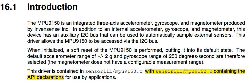

which libraries allow us to use this functions?
hello guys, i wan't to explain in my project which library i use for some functions, for example to read data from MPU9150 which is on sensor hub
MPU9150DataAccelGetFloat
MPU9150DataGyroGetFloat
MPU9150DataMagnetoGetFloat
void
MPU9150I2CIntHandler(void)
and for this is it   #include "driverlib/rom_map.h"?
ROM_SysCtlPeripheralEnable(SYSCTL_PERIPH_I2C7);    ROM_SysCtlPeripheralEnable(SYSCTL_PERIPH_GPIOD);
ROM_GPIOPinConfigure(GPIO_PD0_I2C7SCL);
ROM_GPIOPinConfigure(GPIO_PD1_I2C7SDA);
I2CMInit  ?
i gues for this
GPIOPinTypeI2CSCL(GPIO_PORTD_BASE, GPIO_PIN_0);
ROM_GPIOPinTypeI2C(GPIO_PORTD_BASE, GPIO_PIN_1);
we use   #include "driverlib/rom_map.h"
