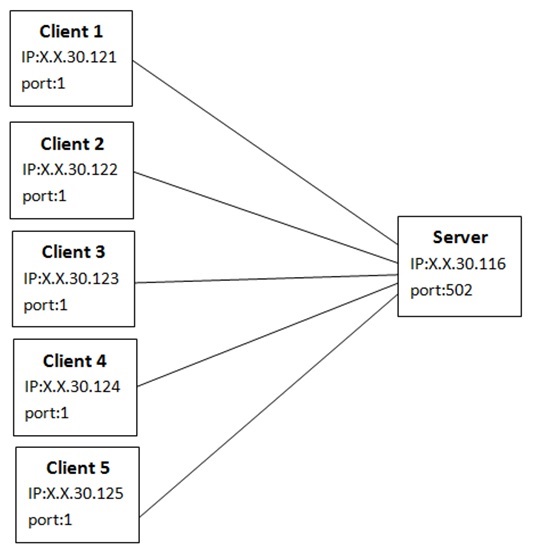

Hi All:
      I try to implement below tcp/ip connect status. Now, Five clients are connected at the same time, I use usr-tcp232(TCP/IP AP for PC) to simulate echo server, and The server can send data to the client individually, I create tcp_test_event() function, it’s called on switch press.
     The current situation, the client can not send data to the server, but when the server send data to the client(wireshark not record). The client will return to the server along with the previous data. (client send to server data is queued. )
ex: Client 3 send “abcdef”, server send data to Client 3(“12345678”) at next time, Will receive the abcdef12345678
