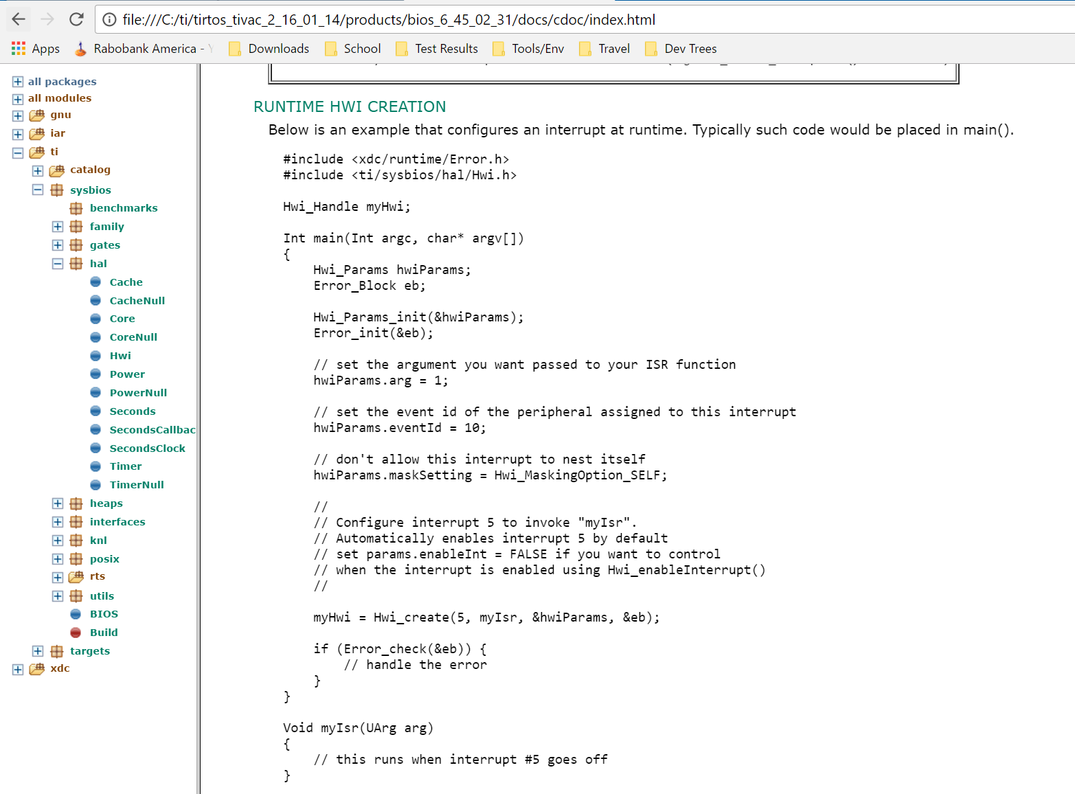

  • When you create the a timer in TI-RTOS, you can specify an arg. For example to create it dynamically:
    Timer_Params timerParams;
    Timer_Params_init(&timerParams);
    timerParams.period = 100000; /* 100,000 uSecs = 100ms */
    timerParams.arg = 5;
    Timer_construct(&timer0Struct, Timer_ANY, (Timer_FuncPtr)timerFunc, &timerParams, NULL);
    Here's the timer function that takes the arg as a parameter. This allows you to use the same timer function for multiple timers.
    Void timerFunc(UArg arg)
    You can create the timer in the .cfg file also.

  • To supply an arg to an Hwi is basically the same. When you create the Hwi, there is an arg field in the Hwi_Params structure that can be specified. When that interrupt is asserted, the kernel calls the user supplied function (supplied in the Hwi_create or Hwi_construct) along with the arg.
    For more details, you can refer to the SYS/BIOS (TI-RTOS kernel) API reference. For example in ti.sysbios.hal.Hwi you'll see this sample code:
