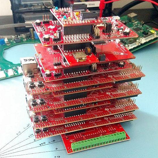

    I don't like that logo either! I was organizing my stuff before going on holidays, and upon seeing so many launchpads, decided to put them together and photograph. The image triggered me a sentence: "Someone suggested me to increase the stack, and so I did". And for I had nothing better to do with the picture, I'll leave it as the "avatar" for the time being!
  • Every Ophthalmologist (in the west) thanks you - and I "withdraw" (for now) my critique of "Portugal's elementary grade art teachings...")
    Our "difference" in diagnostic methods may prove interesting - you "distrust poster's evidence" - while I "welcome & credit it" - and believe greatly in the power of "patterns yielding repetition."
    You appear to be "beating" the (usual) Euro exodus by a month - fare well (and do pray for staff's "visual healing.")
