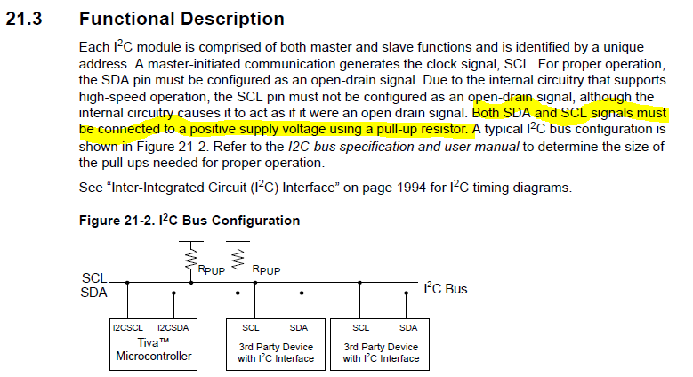

  • Did you provide pull-up resistors? From page 1402 of the data sheet:

    I assumed that at least the SCL line should be pulled high, if it is configured correctly, which I am assuming the example design does. So maybe the example isn't configuring the pullup on SCL???
    The Schematic section towards the end of the UG for this Launchpad is empty (no schematic) so I can't see where a pullup should be placed for either SCL or SDA. I am guessing after looking at the board, that no pads are provided specifically for this. I am thinking could dead-bug an R onto the board next to the appropriate header pin socket on the edge of the board (for connector X11) to wire in the pull-ups. Does this make sense?

  • Adding the pull-up R's on the SCL/SDA signals did the trick. Start, address, write state, NACK (since no slave connected) and stop sequences all as expected. Thank you for the dope-slap. Now on to the real problem...
