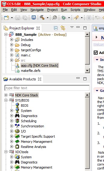

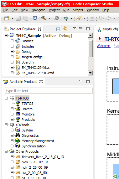

  • Todd,
    Thanks for the reply.
    I guess TI-RTOS isn't SYS/BIOS?   Everyday I get more confused....
    I am using bios_6_46_02_47, and it creates tasks.  I started with a raw "Task" demo, and gutted it to add the NDK code (inside the task).
    It has nothing selected under RTSC for TI-RTOS.
    I selected 2.16.1.14  (my only choice), and added it to my little demo
    Adding that TI-RTOS to the build made no difference.
    I pulled in a simple networking program.  It uses BOTH SYS/BIOS and TI-RTOS.
    I found the linker.cmd buried way under the debug folder.  It is using all packages from
    C:\ti\tirtos_tivac_2_16_01_14\products\ndk_2_25_00_09\packages\ti\ndk.
    NOT the NDK package at the root level of C:\ti\ndk...  Odd...?
    I migrated anything that was in a folder "ndk", both libs and paths, over to my small demo. There were 12 of them.  That reduced it to the NIMUDevice Table.  I did a search and found 128 different files that are EK_TM4C129EXL.c.  Each with the same date/time and same rough size.  I found one of the files that was in a NDK sample.
    I copied over the table, then discovered the need to add two new headers.
    Then it gives me a "Hwi_Handle" is undefined.  I would expect it to be in "hwi.h" in an "m4" directory.  But apparently, you don't use one for "m4" devices, you use the same "m3" folder of the header file.
    Now, it can't find "EMACSnow_NIMUInit" when it links.  The "EMACSnow.h" just says: "This function is needed in the NIMUDeviceTable."
    The problem is that the UI XGCONF is adding "some" libs, which I don't know what they are.  The demo project that works has something like 22.  My sample I am trying to link has 6.
    I am trying to sort out which are tossed in by the config script, which are ones I will have to add.
    I have now totally confused myself and I can't figure out how to link this stuff:
    My imported networking project uses BOTH SYS/BIOS and TI-RTOS for TIVA-C.  BUT!  There is yet another SYS/BIOS inside the TIVA-C folder.  And the linker.cmd lists *all* libraries as coming from "C:\ti\tirtos_tivac_2_16_01_14\products\bios_6_45_02_31\packages\ti"
    My simple DEMO project uses SYS/BIOS, and I added the TI_RTOS. but that does nothing.  And it gets *ALL* it's SYS/BIOS packages from C:\ti\bios_6_46_02_47\packages   I can't just randomly mix them.  So now some are configuration script based, some are not, coming from all different locations.
    This system has succeeded in making a 30+ year developer feel like an idiot...
    -CSW

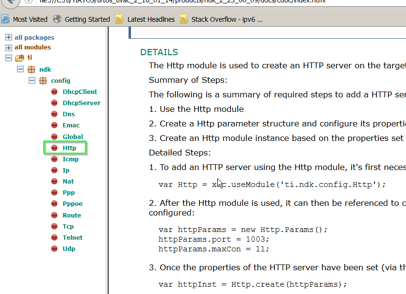

  • Hi Todd,
    Yes, I can run the TCP Echo fine.  It DHCP'd and I could ping it with my PC.  I can also run HttpGet, and just about any other example without any problem.  It's building my own that is difficult.  (Also, simply taking an existing, working, example then "Add the HTTP service module" generates 6 unresolved linker errors...  so modifying an existing example doesn't solve my issues either)
    I am comparing two example projects that work:  HttpGet and tcpEcho to my test program that doesn't link.  (They use GCC, my test project uses TI... I am also trying to make a test project with the GCC compiler... a different kind of problem there)
    I notice that, using XGCONF, neither the HTTPGet nor the EchoTCP have the "DHCP Client" selected in the UI for the CFG file.  But both samples manage to get IP addresses from my DHCP service.  How is that happening?
    I also notice the linker.cmd file for the HttpGet project is adding "ns_1_11_00_10\packages\ti\net\lib\network_ndk.am4fg" and "ns_1_11_00_10/packages\ti\net\http\lib\http_ndk.am4fg"
    How did it decide to add those?    I can see on the right side (Outline) that "Http" is listed for the HttpGet, however I can find no way to add it to the other project.  In other words, the sample just "contains" it, but the CCS doesn't give you anyway to add it to a project.  Also, I thought the NSP was not needed anymore?  I see Wiki statements claiming that.  However there is an NSP package inside my TIRTOS-TIVAC, as well as one at the root of C:\TI.  They are nowhere near the same.

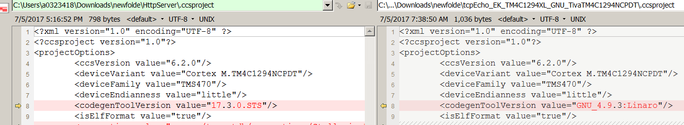

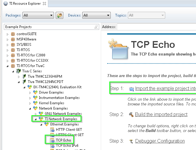

    There should also be versions of these examples that build using the TI tools. Were you not able to find them?
    I'd recommend importing those ones, since your project is using TI tools. Having GCC vs TI tools is just another variation that will add to the confusion at this point.
    Steve

    Import the TM4C1294XL example HttpGet.  Build it, load it, debug it.  See that it connects to "www.example.com"  No problem, except I don't want a client. I want a server.  If the stars are in alignment, and I have a good tail wind, I can get the XGCONF GUI up, so I "Add the "HTTP server module to my configuration".  Add an instance "http0". Then try to build.
    I think you should avoid the HttpGet example. As you discovered, this is just for an HTTP Client. This example won't help you.
    Better to stick with the tcpEcho example and go from there.

    There is also documentation on the NDK configuration settings (i.e. the JavaScript configuration code for the NDK that you can set in the *.cfg file) and so I wanted to point you to that.
    It's in the NDK under the docs folder, for example it's here on my machine:
    C:\ti\tirtos_tivac_2_16_01_14\products\ndk_2_25_00_09\docs\cdoc\index.html
    This file will give you info on each of the modules that you can configure for the NDK.
    For example, you can see info on configuring the HTTP server:
    Steve

  • A couple of things stand out.
    Most notably, the working project is using the TI compiler.  The non-working is using the GNU compiler:
    You might try importing the tcpEcho example for the TI tool chain and retrying this experiment:

    I started with a work space that was uncontaminated.
    When I import the tcpEcho project from the GCC compiler, build it, add the HTTP server, and rebuild it I get the missing functions.
    When I import the tcpEcho project from the TI compiler, build it, add the HTTP server, and rebuild it it builds without any missing functions.
    Same problem:
    C:\ti\tirtos_tivac_2_16_01_14\products\ndk_2_25_00_09\packages\ti\ndk\nettools\lib\nettool_ipv4.am4fg(httpclie.om4fg): In function `httpClientProcess':
    /db/vtree/library/trees/zumaprod/zumaprod-j14/exports/tirtos_tivac_2_16_01_14/products/ndk_2_25_00_09/packages/ti/ndk/nettools/http/httpclie.c:331: undefined reference to `efs_filecheck'
    /db/vtree/library/trees/zumaprod/zumaprod-j14/exports/tirtos_tivac_2_16_01_14/products/ndk_2_25_00_09/packages/ti/ndk/nettools/http/httpclie.c:352: undefined reference to `efs_loadfunction'
    C:\ti\tirtos_tivac_2_16_01_14\products\ndk_2_25_00_09\packages\ti\ndk\nettools\lib\nettool_ipv4.am4fg(httpsend.om4fg): In function `httpSendFullResponse':
    /db/vtree/library/trees/zumaprod/zumaprod-j14/exports/tirtos_tivac_2_16_01_14/products/ndk_2_25_00_09/packages/ti/ndk/nettools/http/httpsend.c:268: undefined reference to `efs_fopen'
    /db/vtree/library/trees/zumaprod/zumaprod-j14/exports/tirtos_tivac_2_16_01_14/products/ndk_2_25_00_09/packages/ti/ndk/nettools/http/httpsend.c:282: undefined reference to `efs_getfilesize'
    /db/vtree/library/trees/zumaprod/zumaprod-j14/exports/tirtos_tivac_2_16_01_14/products/ndk_2_25_00_09/packages/ti/ndk/nettools/http/httpsend.c:287: undefined reference to `efs_filesend'
    /db/vtree/library/trees/zumaprod/zumaprod-j14/exports/tirtos_tivac_2_16_01_14/products/ndk_2_25_00_09/packages/ti/ndk/nettools/http/httpsend.c:291: undefined reference to `efs_fclose'
    So, that means these "efs_..." functions are present in the TI build, but not in the GCC build.
    (In both cases, since it was a fresh, unmolested example, there was no HTTP client to remove)
    So, now we know the GNU builds are defective.
    Case closed  :-)  Except for the libs requiring to be rebuild to fix this.

    Allow me to clarify...  From the document by Todd on how to add the HTTP server, (which was great)  it doesn't seem to apply to Sitara.  The first step in the document is to highlight "TI-RTOS", but it's not present...  I've installed everything, plus the kitchen sink.  So I don't know what I'm missing.
    Two images, next to each other...  The TM4C1294 device  ------   compared to Sitara.
    Thanks for anything at all - Please.
    -CSW
