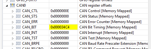

    I have reliable CAN communication at 1M baud with 50MHz system clock using:
        // 50MHz from 16MHz crystal
        SysCtlClockSet(SYSCTL_SYSDIV_4 | SYSCTL_USE_PLL | SYSCTL_OSC_MAIN |
                       SYSCTL_XTAL_16MHZ);
        CANBitRateSet(CAN0_BASE, SysCtlClockGet(), 1000000);
  • The CAN0 registers are set as shown: *** Corrected ***

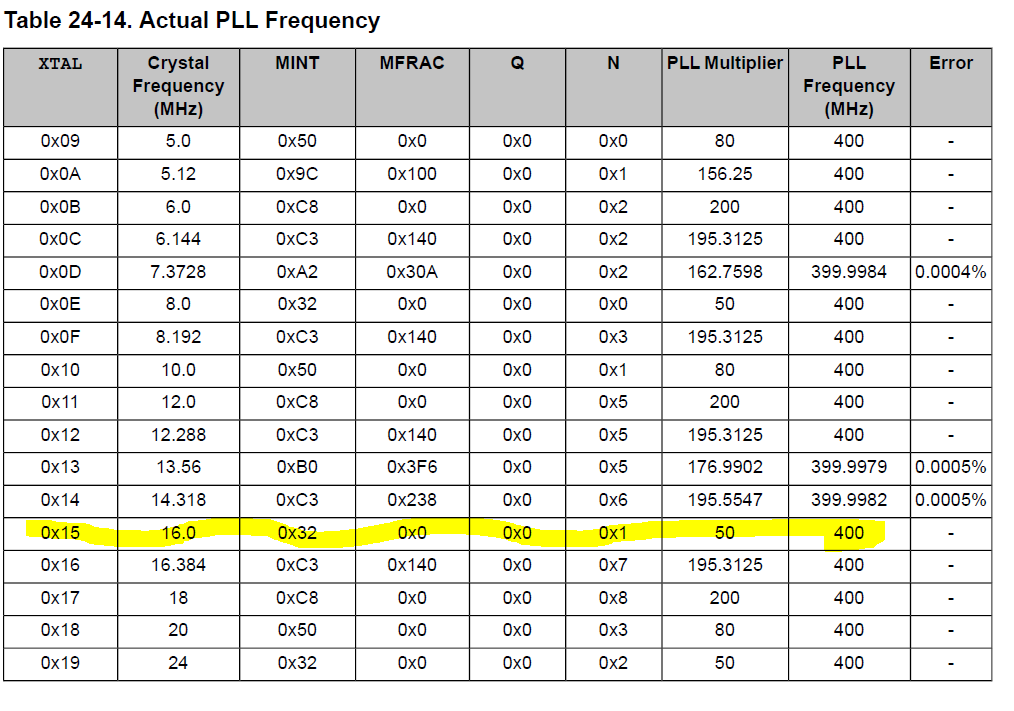

    SysCtlClockSet(SYSCTL_SYSDIV_8 | SYSCTL_USE_PLL | SYSCTL_OSC_MAIN | SYSCTL_XTAL_16MHZ);
    Might that  "50MHz from 16MHz crystal"  result (instead) from, "SYSCTL_SYSDIV_4"?
    TM4C123 runs PLL @ 200MHz (iirc) - thus the divide is 4.
  • CB1, as always thank you for double checking me. I pulled this table from page 1374 of the data sheet which shows the PLL at 400Mhz. The CAN worked correctly at 1MBaud (connected to a NI USB CAN module) which implies that I really was operating at 50MHz using SYSCTL_SYSDIV_8.
  • CB1, I should never question your corrections. You are correct. It should be SYSCTL_SYSDIV_4 since the PLL is divided by 2 before it goes to the system clock divider. I was running at 25MHz, and the software correctly calculated the settings for a CAN baud rate of 1MBaud based on 25MHz system clock.

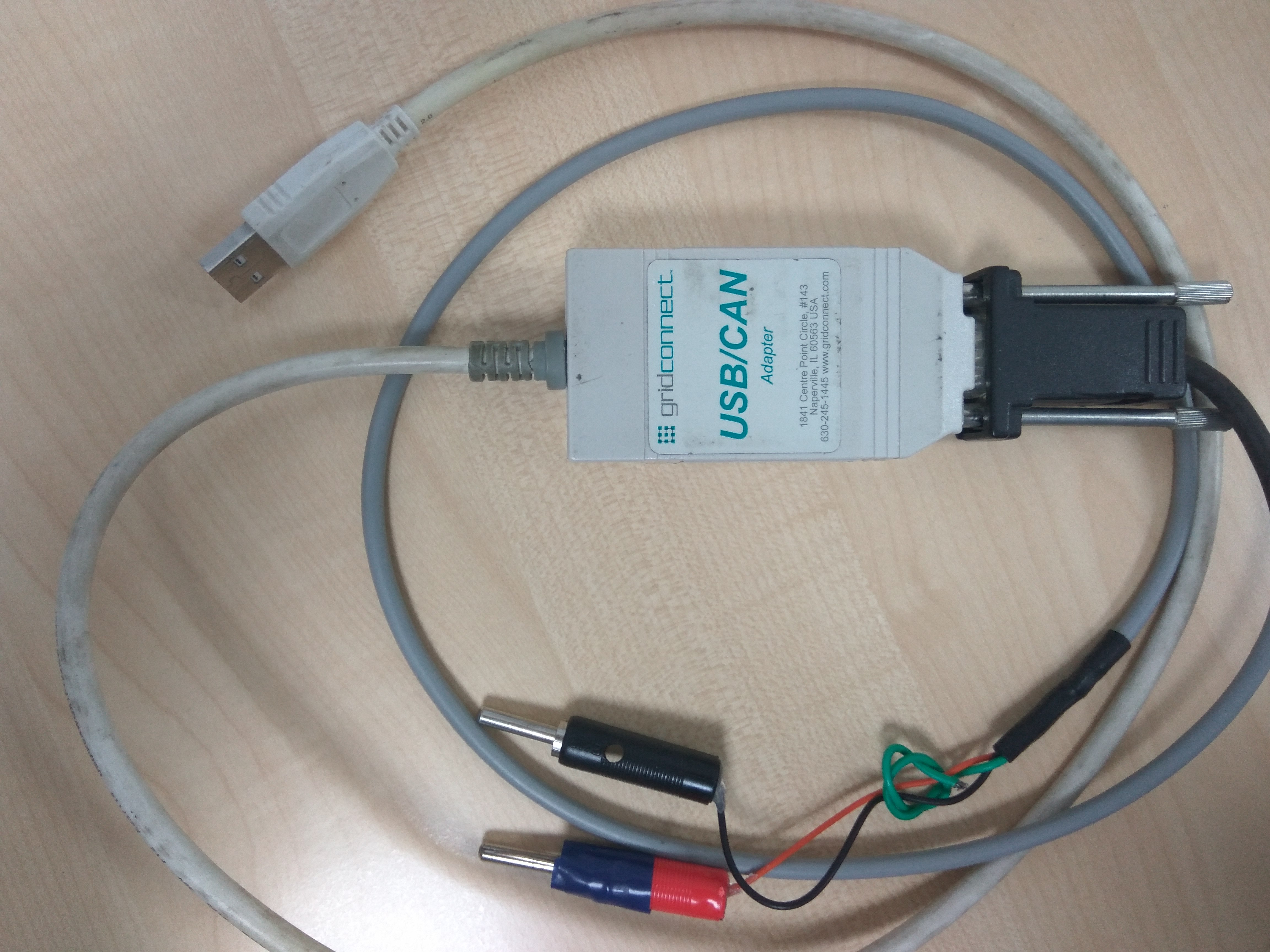

    I am using gridconnect USB/CAN adapter and its length is about 1 meter , connected between hardware and PC.
    And i will try with another board.

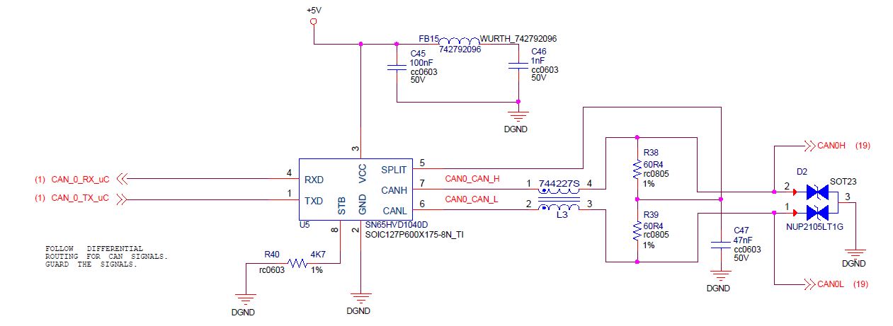

  • Dear Robert,
    This is how the hardware interface is:
    One metre is good, but that still leaves the questions about termination and cable.

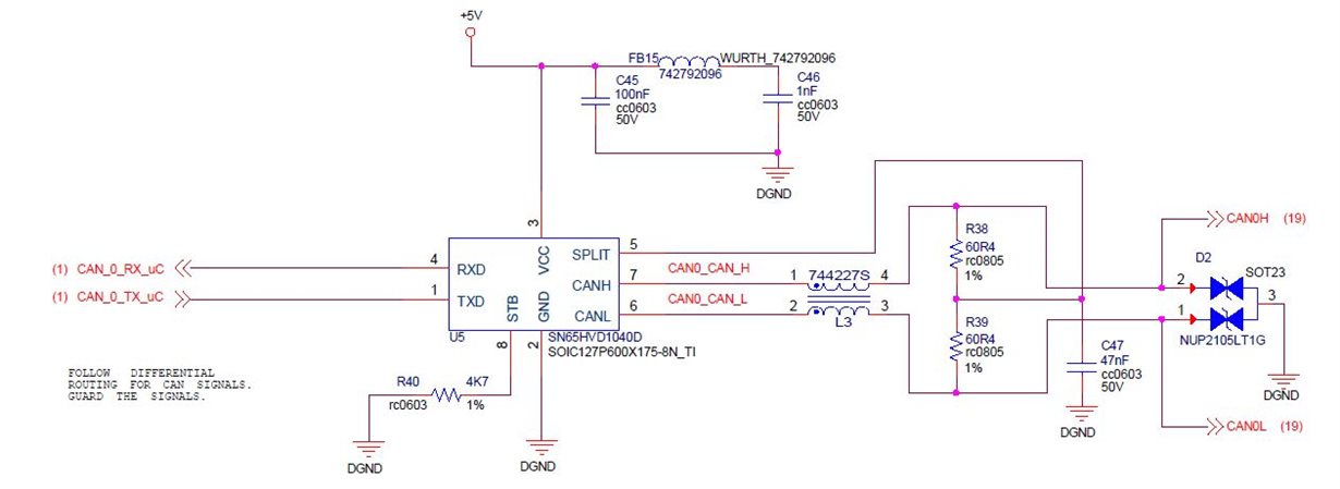

  • This is how the hardware interface is:
    Look (very) fast folks!
    ("some" effort (review) required when posting...)       Note that the "empty" hardware interface has (like "LIKE") gone AWOL!      (yet has been (twice now) preserved...)
  • Thank you for updating the hardware interface
  • Good Manuraj,
    That looks good. What about the other end and what about the cable?
    Robert

    We are using grid connect USB/CAN Adapter device and length of the cable is about 1 meter. And we have been using the same set-up for the past 5 years.
    Refer the below snapshot for device and cable.
  • Your CAN interface schematic is quite good - yet the CAN Xcvr is powered from 5V - not 3V3. Might that alone account for the "fall-off" you note at the highest (i.e. most demanding) CAN Data Rates? (Your MCU outputs 3V3 - which may prove "marginal" for a 5V powered IC - especially at extreme data rates!)
    3V3 CAN Xcvrs ARE available - and are likely to "fit" your existing pcb footprint...
  • Ok, cb1 caught the power supply issue on the transceiver. This photo shows two others. First there is no evidence of a terminator, that's even more important on a MBps bus. Second that looks like only a portion of the wiring which then splits out in some unknown fashion before connecting to your board.
    Robert
  • One other thing. I can't tell for sure from that photo but that cable looks suspicious as well. What is the impedance of the twisted pair? Does it even have a twisted pair?
    Robert
