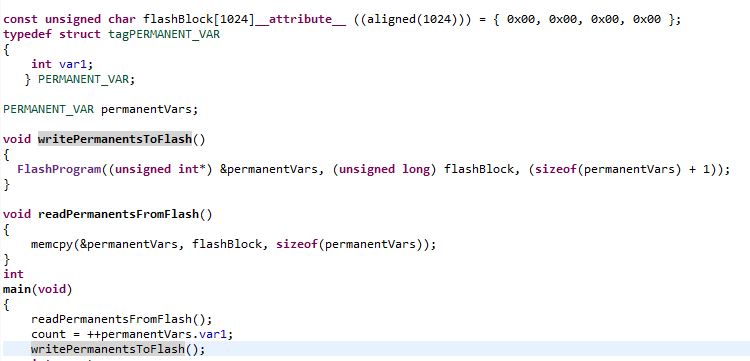

To store a variable in flash memory and to update the variable, I used the following code.
The image is to be executed based on the variable in flash memory. But while using writePermanentsToFlash(), the image is not executing. If I comment it, then the first image executes. What will be the problem? Should I change anything inside the function? Please give me a suggestion.
    I think more details are needed before anyone could approach an answer. In particular what does "the image is not executing. If I comment it, then the first image executes" mean?
    However I see several potential issues
    • attribute may not be supported by your (unnamed) compiler
    • You don't appear to have erased the flash
    Robert

    I have to execute two images from boot code. The boot code and the two images are stored in flash memory. A variable has to be stored in the flash memory and according to the variable, switching between images has to be taken place on resetting. I used the above program to store variable and update it in flash memory. But write to flash function did not work properly. What can I do to make it work?
    Did you read the rest of my message?
