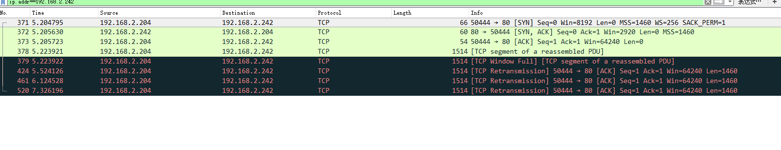

Web socket can't receive vast data,it is  more than its receiveBufSize.  A  file is 16KB. I pass it by Web . Web pass it by post .  I reveice the post data . now I can't reveice it . if a file is 1KB. I revece it OK.
my receiveBufSize = 2920;
my code :
while(iNumParams)
     data_legnth = recv(htmlSock, pcParam, 1460, 0);
     iNumParams=iNumParams-data_legnth;
    ......//do some  thing

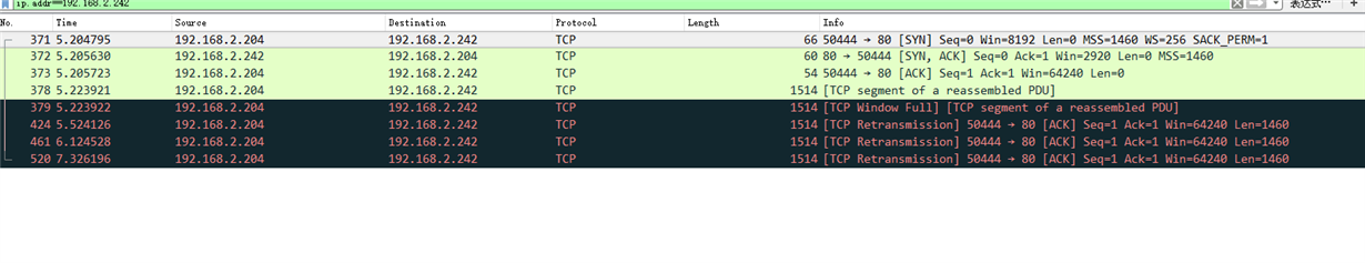

Wireshark    192.168.2.242 is my mcu        192.168.2.204 is my pc
