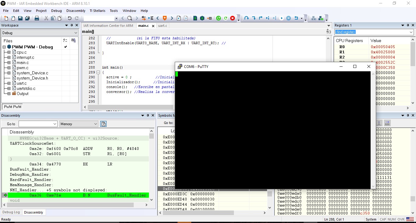

Hi guys, I'm trying to build a program that controls the LED RGB intensity using PWM, but there's a catch, the value of the intensity MUST be entered using serial communication (UART) via Putty. In both cases, interruptions must be used.
There are no compilation errors, put when the program runs on the launchpad, it doesn't show anything on putty (it's set correctly), and when the program is paused, it frezees on busfaulthandler or falut handler.
If you could give me a hand on what the problem is, i'd appreciate.
Thanks in advance. Mili

  • Would it not make "great sense" for you to simplify - by applying, "Divide & Conquer" strategy - to best achieve your objective?     (such strategy is called, "KISS.")
    Note: I've looked just (very) briefly at your code - are you aware that each PWM Generator employs a specific MCU pin - from which output is produced?     Your code - instead - appears to tie the Led to a GPIO - which is not directly controlled by the PWM Generator.
    For example - here is (long past) code - known good - used by my firm to generate PWM Outputs from the PROPER PWM Specified Pins.    (NOT ALL Pins are PWM capable!)

    Both of those "Pin Configuration" functions do not appear w/in your code - and they should - should they not?    (again - I've made brief/fast scan of your code - that's YOUR job...)

    *** Do note that the Led Pin (PF2) is NOT ordered into PWM Configuration (as your code above reveals) - which DEFEATS your purpose!
    More time/effort w/in the PWM section of the MCU Manual will enhance your understanding - and compliance - with the "rules" of these complex MCUs.    Again - one or several pages of the MCU Manual - w/in the PWM Section - clearly specify those pins which "attach" to the PWM Generators!     Pins w/out such PWM listing - are not PWM Controllable!    (by the PWM Generators)
    As it stands now - your PWM Generation is "held hostage" by your UART - and it may be that the "UART" or the "PWM Gen" or "both" are at fault!     And - with the MIX you've created - how would you (even) begin to know,  "where & how" to look?
    I'd suggest avoiding the UART for now - focus instead entirely upon the PWM Gen - and making it work - starting with (again) the simplest/easiest (i.e. One SINGLE PWM Channel to just one color of that tri-color Led.)     Once you've got one color properly performing - you may move on to the 2nd - which (really) involves little more than just "changing" the "Source PWM Generator" (i.e. you add a new one) and changing the signal output to the 2nd Led Color lead.    (and so for the 3rd one.)
    Once that's achieved - you may simply experiment w/the UART - get that working (BY ITSELF) and only (then) attempt to "join the UART received data to the choice of Led color."    (achieved by variation of the color "mix" @ the tri-color Led.    That color "mix" is achieved by variation of the "duty cycle" of each of the PWM Generators - the higher the duty cycle - the brighter that particular color.)

  • No need for sorrow - do "read again" my posting. (I've added 3x to it) There are serious code mistakes w/in the set-up & config. of your PWM Generator - more time w/the MCU Manual is indicated. Do read again - maybe twice - it will then be clearer...
