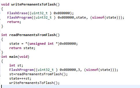

I have to do my program like after every reset the execution of image have to be switched according to the value of the variable stored in flash. For that I increment the variable in my program and write to flash. After every reset this variable has to be read from flash. For storing the variable in flash address 0x080000 and then to read the variable, I did as shown in the snapshot below. But it is not working. Please help to do my program in the right way.

  • Sandra,
    1. Help us help you by using a subject line that means something. The date is not meaningful. You've been corrected on this multiple times and you've agreed it was wrong.
    2. Don't past you code as an image use the past code option </>
    Since you didn't post your code properly I cannot quote the lines in question but
    The FlashProgram line in main is almost certainly wrong in concept. Do you really want to write to address 3? It certainly violates the documented alignment constraint that all address and sizes must be divisible by four.
    There's a very good chance that the programming line in wrotePermanentsToFlash is also wrong but you don't reveal what state is so it's hard to tell.
    Finally you need to re-read the documentation, the first argument to FlashProgram is not the storage location.

    Extremely regret for the mistake I have committed again. While selecting date, month was chosen first, so the mistake happened. Sorry.
    Regarding the issue I had posted, the problem is solved.
