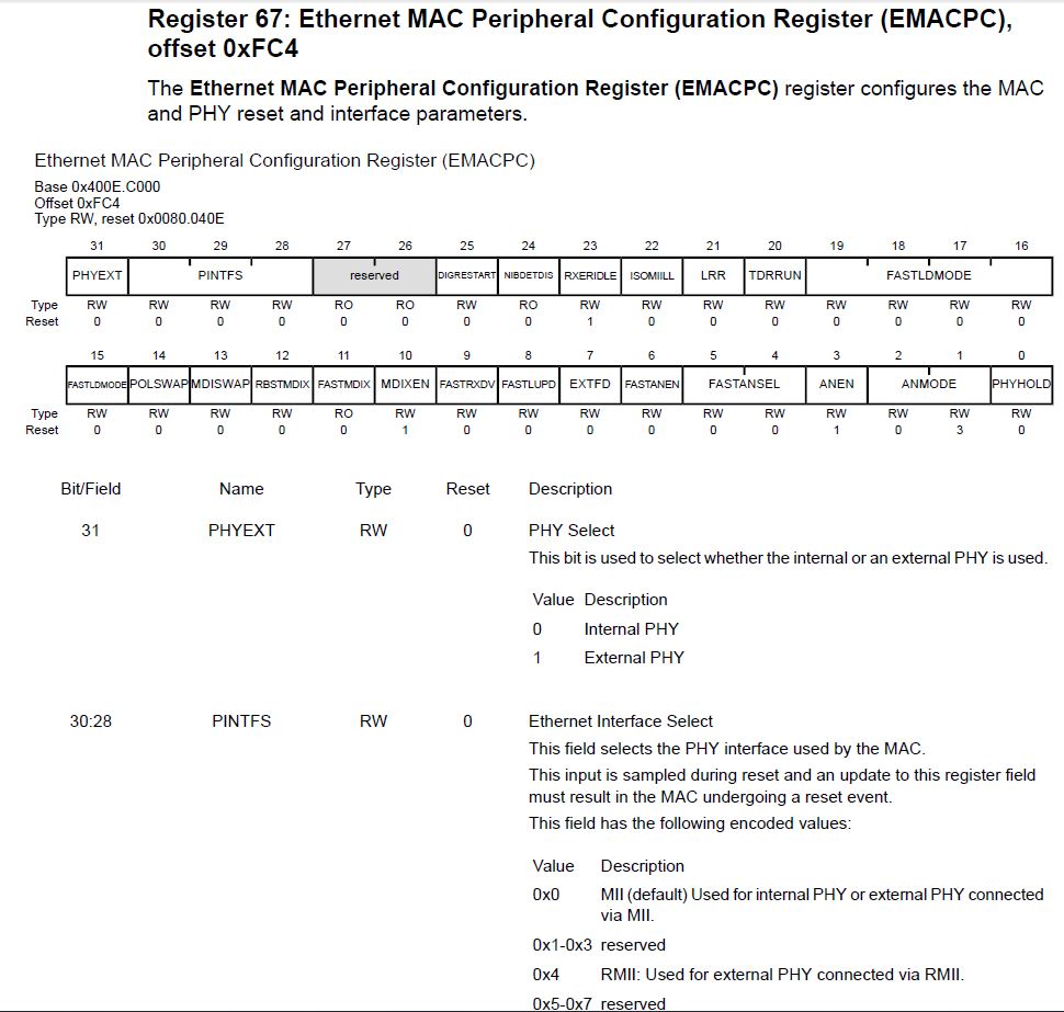

He is planning to use external Ethernet PHY.
It is mentioned on datasheet to program PINTFS bit field to 0x4 in the Ethernet Peripheral Configuration (EMACPC), but EMACPC is marked as read only.
Is it possible to share EMACPC register description with me?
Do you have a software examples regarding TM4C129DNCPDT and external ethernet PHY besides TivaWare examples?
