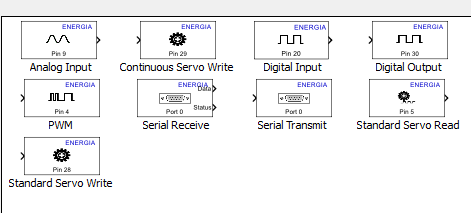

  • Hi cb1_mobile & ,
    I want to read quadrature encoder signal on TM4C processor using simlink.
    There are only following simulink blocks available for TM4C processor.
    If the simulink block is not available then can we use some other protocol like spi to read
     quadrature encoder signal??
    please help.
    Thanks in advance.
  • Anil gupta said:
    If the simulink block is not available then can we use some other protocol like spi to read  quadrature encoder signal??
    Not being a "simulink" user (nor is staff) I can only supply what I trust to be a logical method to (generally) solve such problem.
    Your neat listing of "simulink functions" reveals neither, "Quadrature Encoder" or "SPI" solution blocks.    Thus your mention of  "SPI" registers as "curious."
    You must learn - "if and how" simulink proves "accepting" of:
    • the introduction of a, "standard C code block" (implementing the "encoder read function) yet placed (entirely) outside of the simulink implementation
    • or - your creation of a (unique & proper) simulink block - which accomplishes your mission (QEI encoder read)
    • perhaps - if simulink is "not accepting" of (either of the above methods) - is it possible to, "Switch simulink between "Enabled/Disabled" - such that you can regularly run your QEI, C code (simulink disabled) - and then return to simulink (now enabled)?    And regularly repeat this process - such that your QEI code (not part of simulink) is able to (effectively) co-exist w/simulink.
    Are these not (purely) simulink issues/questions - thus more pertinent to "simulink staff/helpers?"    Believe the "bullet points" listed are valid - and the "best response" likely results from simulink - not TM4C guides/signposts...
