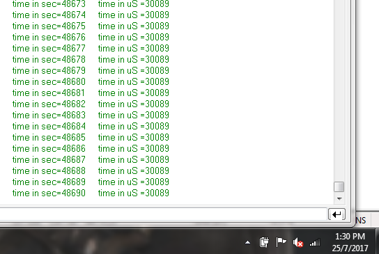

I am able to get the RTC count in seconds.But the sub second count is not correct.
I attached my program and a snap shot of RTC values

    I am not using Hibernate interrupt routine. My main something like this.
    void main()
    enableRTC();
    setRtcValue(43200);//12 PM
    while(1)
    uint32_t timeInSecond,timeInSubSecond;
    timeInSecond = getRtcValueInSec();
    timeInSubSecond = getRtcValue();
    Here timeInSecond will change in every second. But timeInSubSecond will sometimes show the same value for a couple of seconds then it will change to any other values. In my 1st commit I attached a screen shot where PC time and timeInSecond are same. But timeInSubSecond smaller than timeInSecond .When timeInSecond increased from 48673 to 48690(ie 17seconds) timeInSubSecond is same (30089). If I am correct timeInSubSecond should increment with 1/32,768 second resolution. That is I should get a count of 32768 for each second.For 17s it should be 17*32768.
  • The subsecond register is only 15 bits wide. The function getRtcValue() will never return a number larger than 32,767.
