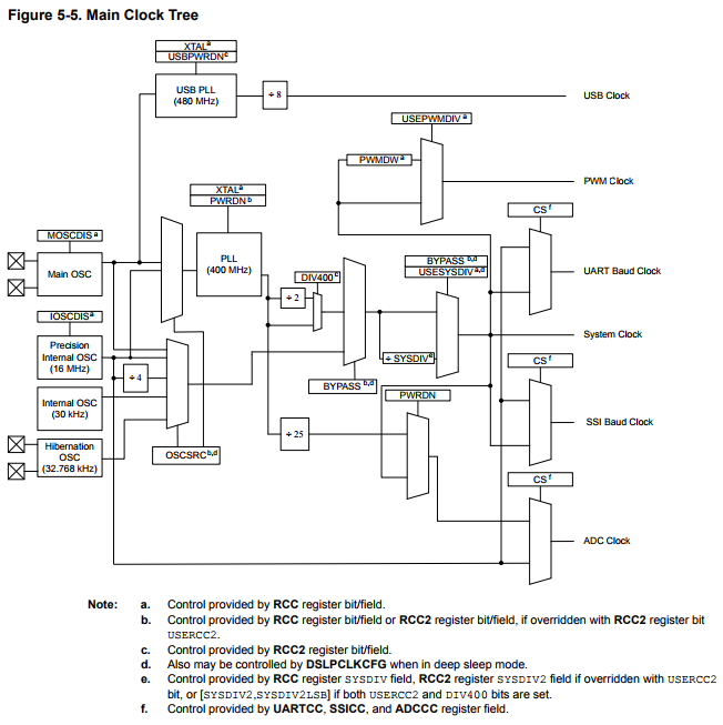

  • Garrett Mize said:
    However, moving forward I would like to have Timer 3 operating at 4.096MHz, while the system clock remains at 80MHz, to produce a 16kHz PWM signal. I can't seem to find an API in driverlib that supports this division from the system clock.
    The Main Clock Tree from the TM4C123GH6PM datasheet shows that the PWM Clock can only be a divided down version of the System Clock:
    Where the PWM clock can be the System Clock divided by 1, 2, 4, 8, 16, 32 or 64 (PWM_SYSCLK_DIV_1,PWM_SYSCLK_DIV_2, PWM_SYSCLK_DIV_4, PWM_SYSCLK_DIV_8,PWM_SYSCLK_DIV_16, PWM_SYSCLK_DIV_32, or PWM_SYSCLK_DIV_64).
    Given the clock tree restrictions, I think the closest you can get to the required clock configuration is:

  • Garrett,
    The closest to 4.096MHz you can obtain on a TM4C123 is either 4.167MHz (with the main clock @66.67MHz or 50MHz) or 4.21MHz (with the main clock @80MHz).
    No need to use the PWM peripheral for that (or pre-dividers, which GPTM's don't have in Tivas), just use GP Timer on with the proper load set.
    Any of these main clocks will allow also divisions that get very close to 8K, 16K, 22K and 44KHz.
    As for the main clock, I understand that the fastest your main clock, the more you will have"sound resolution" available - not sure if that will influence on the applications desired sound quality, but it might be good to run the chip as fast as possible.

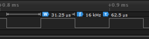

  • 2703.PWM_DAC_Design.pdfHi Robert,
    The output PWM is being pushed through a low pass filter and audio amplifier before output on the speaker. I have attached the reference design documentation which contains the parts used on the audio booster pack.
    As I told Bruno I am simply using a logic analyzer at the moment on pin PB2 to look at the PWMs created on tiva. This is the pin that will eventually be used to output the signal to the booster back once the clocks are configured correctly.
    Garrett
