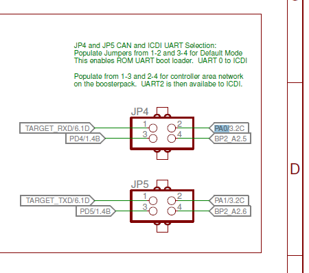

Hello, I am trying to test code from TI 'simple_tx' for can bus communication with my EK-TM4C1294XL board.
All I want to see is just simple signal with information from can TX pin before it goes into CAN transceiver.
I configured output pin for PA1 for CAN TX but I do not see any signal with the information(it shows just flat signal with 3.3V).
Can you please help me out?

//! This example uses the following peripherals and I/O signals.  You must
//! review these and change as needed for your own board:
//! - CAN0 peripheral
//! - GPIO Port B peripheral (for CAN0 pins)
//! - CAN0RX - PB4   PA0   // ######################################################
//! - CAN0TX - PB5   PA1    // #####################################
//! The following UART signals are configured only for displaying console
//! messages for this example.  These are not required for operation of CAN.
//! - GPIO port A peripheral (for UART0 pins)
//! - UART0RX - PA0         PP0  //########################################
//! - UART0TX - PA1         PP1 //########################################

    SysCtlPeripheralEnable(SYSCTL_PERIPH_GPIOA);  //##############################################
    // Configure the GPIO pin muxing to select CAN0 functions for these pins.
    // This step selects which alternate function is available for these pins.
    // This is necessary if your part supports GPIO pin function muxing.
    // Consult the data sheet to see which functions are allocated per pin.
    // TODO: change this to select the port/pin you are using
    GPIOPinConfigure(GPIO_PA0_CAN0RX);  //###############################
    GPIOPinConfigure(GPIO_PA1_CAN0TX);  //###################################
    // Enable the alternate function on the GPIO pins.  The above step selects
    // which alternate function is available.  This step actually enables the
    // alternate function instead of GPIO for these pins.
    // TODO: change this to match the port/pin you are using
    GPIOPinTypeCAN(GPIO_PORTA_BASE, GPIO_PIN_0 | GPIO_PIN_1);  // ##################################
