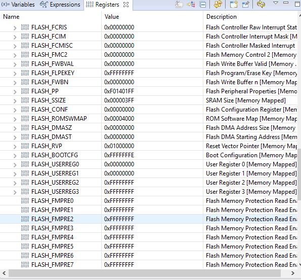

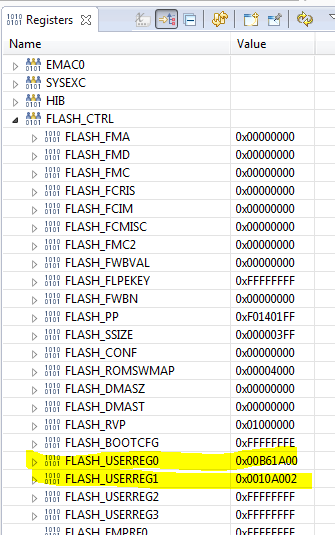

  • Perhaps the flash user registers on your device have already been programmed. If you erase the device so it no longer has your code in it, then do a power-on-reset. Now connect with CCS and look at the FLASH_USERREGn in the "Registers" window as shown in the picture below:

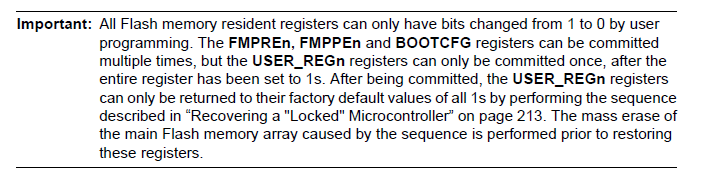

    If your device, like mine, shows something other than 0xFFFFFFFF in FLASH_USERREG0 or 1, they have already been programmed and saved. When you write to these registers again, the value you write is "ANDED" with the value already there. (The flash can only be programmed 1's to 0's.) This may explain why you always read 0's.
    by default I am getting the register value as below, Even if write anything, no changes to these registers.
    Manohar

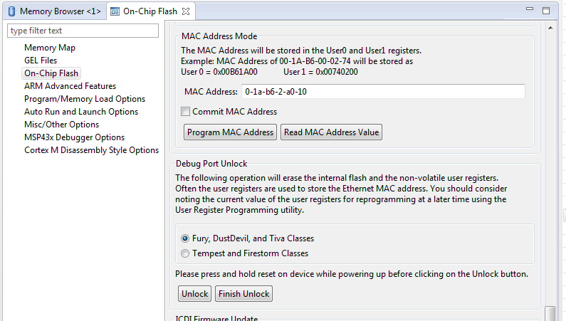

  • It appears that your FLASH_USERREG0 and FLASH_USERREG1 have already been set to zero and committed. Since flash bits can only be programmed from 1 to 0, you cannot make any changes to these registers until they are erased. The only way to erase the Flash User registers is to follow the “Recovering a "Locked" Microcontroller” procedure. From page 614 of the datasheet.
    This can be done with CCS.
