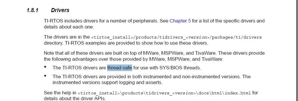

I am using driver calls from the location <tirtos_install>/products/tidrivers_<version>/packages/ti/drivers, Its mention in TI RTOS user guide that the driver calls are thread safe.

  • Hi Manohar,
    The usage of each I2C instance is thread-safe. For example if you call I2C_open with the Board_I2C0 (which is really EK_TM4C129EXL_I2C7) index, you'll get back an I2C_Handle. Let's call that i2cHandle0.
    Multiple tasks can use the i2cHandle0 to initiate transfers. Internally in I2C_transfer (actually in the lower level i2c driver), a semaphore is used as a mutex to make sure only one task is setting up the transfer at once. Here is the line of code in the i2cTiva.c file
    Semaphore_pend(Semaphore_handle(&(object->mutex)), BIOS_WAIT_FOREVER);
    Now the driver sets up the transfer and calls Semaphore_pend on a separate semaphore (call it the transfer complete semaphore). When the transfer is complete, the Hwi calls Semaphore_post on the transfer complete semaphore. This releases the task that was blocked. Now it calls the following
    Semaphore_post(Semaphore_handle(&(object->mutex)));
    to allow any other task to do the a transfer (if one was blocked on the Semaphore_pend listed above.
    If you had a different I2C instance (call it i2cHandle1). If there is a transfer going on for i2cHandle0, you can still do a transfer for i2cHandle1 since they have different semaphores to provide thread-safety.
