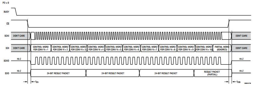

My goal is to achieve the uDMA operation through SPI interface to read the samples continuously from LTC2333-16 ADC without much micro controller intervention.
Through TM4C1292NCPDT datasheet we understood that uDMA is possible with SPI interface. i.e SPI will issue DMA request whenever SPI data buffer gets filled. uDMA will be configured in ping-pong mode to receive the data from SPI to memory and generate the processor interrupt whenever uDMA ping/pong buffer gets filled.
LTC2333-16 ADC has an option for configuring control words i.e pre-determined order for channel selection in sequence mode of operation. However CNV i.e. convert signal is required for each channel to start the conversion from master. BUSY signal de-assert when conversion is complete and expecting SCKI signal from master to drive SDO data. Please look at the timing diagram for single sample below.
To use the internal sequencer of the LTC2335-16, we have to program it as described below with the desired sequence of up to 16 configurations. Each of these configurations specifies the desired channel number and SoftSpan range for one conversion. The LTC2335-16 will then apply the first configuration to the first conversion, the second configuration to the second conversion, and so on until the end of the programmed sequence is reached, at which point the cycle will start again from the beginning.
Now i have plan of using Timer pulses for handling CNV signal for each sample. However SPI should have some kind of handshake signal between ADC BUSY signal and drive the Master clock without processor intervention.
Please clarify the following.
  1. Should SPI capable of handling BUSY signal to drive the master clock to ADC without processor intervention for every sample read?
  2. Please suggest if any logic can be implemented to handle the handshake between BUSY signal and SPI master clock.
  3. Is it possible to give some signal from uDMA to ADC after every sample read from SPI buffer without processor intervention?

  • Hello Bala,
    1) No, the SPI should and would not be capable handling the BUSY signal without the processor controlling it to do so
    2) Have a GPIO w/ interrupt on the BUSY pin and when it drops low then queue the SPI bus to begin communication to read out the ADC result
    3) There is no signaling capability from uDMA to the external ADC. However, it could be maybe possible to setup another DMA channel to that you could perform DMA transfer from the RAM to the GPIO. Then you could use the GPIO signal to signal the external ADC? This isn't exactly an efficient method though as neither the DMA nor the CPU can do bit writes so you probably would be better off trying something like outlined in answer 2.

    Let me explain clearly on my queries.
    I want to read the 24bit data from LTC233-26 ADC via SPI interface continuously i.e using DMA without processor intervention. from LTC datasheet i understood that its required CNV signal and SCKI from SPI master for sending SDO data after BUSY signal transition from high to low. in this case i am planning to add some external hardware circuitry to control the CNV signal and provide the clock to ADC after BUSY signal alert.
    1. if i configure TI micro controller SPI as slave device with external clock, will uP SPI slave able to receive the from ADC which clock is irregular?
    2. is it possible to set the DMA data transfer while SPI in slave mode?
    Bala
  • Hello Bala,
    1) In general this should be okay because what matters is the edges for clocking in data. That said, you need to be careful that the period does not get too small. The TM4C12x devices cannot have SCLK to the slave higher than 1/12 of the system clock, so therefore the clock cannot have periods of time that exceeds this limit. Other than that, it should be okay, but by having an irregular clock you may be adding a lot of complexity as far as debug is concerned as you have to make sure the frequency stays within the aforementioned range. For full understanding of Slave mode timing, see the specs on Section 27.17 of the device datasheet (one of the notes includes the mention of the 1/12 SysClk requirement).
    2) Yes, this is possible to do. If you are not sure how to do this, search the E2E forums for "SPI Slave DMA" - many queries have been made on this topic and there is a lot knowledge available for you to browse through! :)
