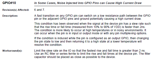

    Bruno Saraiva said:
    I could not find the errata you mentioned, neither for TM4C123 nor for 129. Found nothing on the #ELEC entries, nor #GPIO entries, let alone searching for "edge"... what is this "edge rate restriction" errata that you mean?
    GPIO #10
    Errata said:
    A fast transition on any GPIO pin can switch on a low resistance path between the GPIO pin or the adjacent GPIO pins and ground potentially causing a high current draw.
    Robert

    I also want to comment on erratum GPIO#10.
    This erratum comes from the fact that on the TM4C devices the ESD protection comes from not only voltage activated zener diodes, but also a circuit that reacts to the very fast change in voltage caused in an electric discharge. We don't want that circuit to turn on when your input signal is switching, but we do want it to turn on when an ESD event happens. Since there is no input signal on an unconnected pin, erratum GPIO#10 does not apply.
