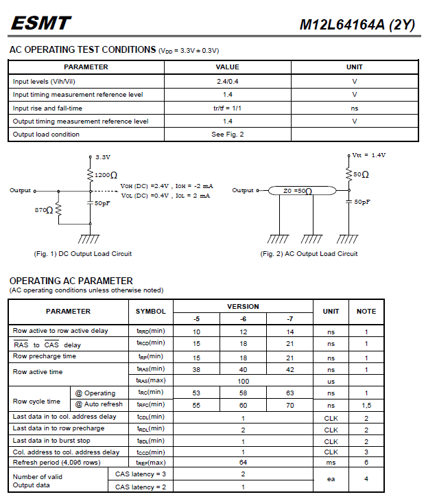

It's almost 2 years that we are producing our boards: MCU TivaC129 + external EPI SDRAM (for frame buffer).
We've choosen SDRAM ESMT M12L64164A(2Y) for our purpose and all was fine.

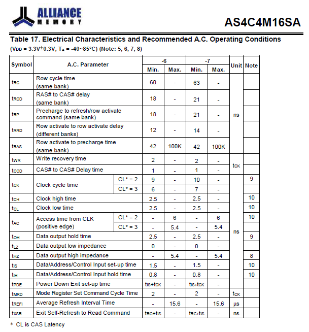

Now we've produced 6 samples with new SDRAM Alliance AS4C4M16SA, because there are some problems to find the above part number.

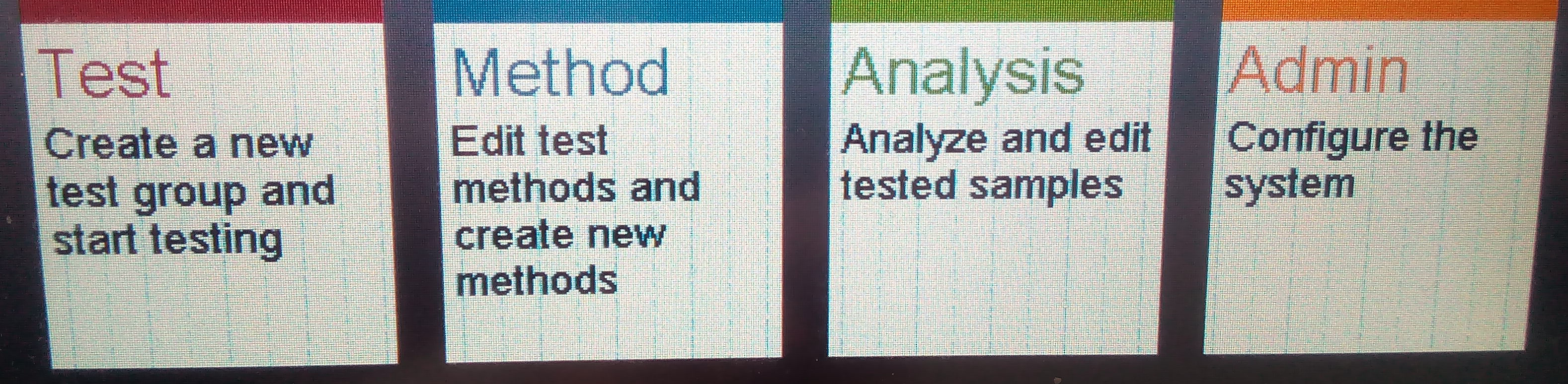

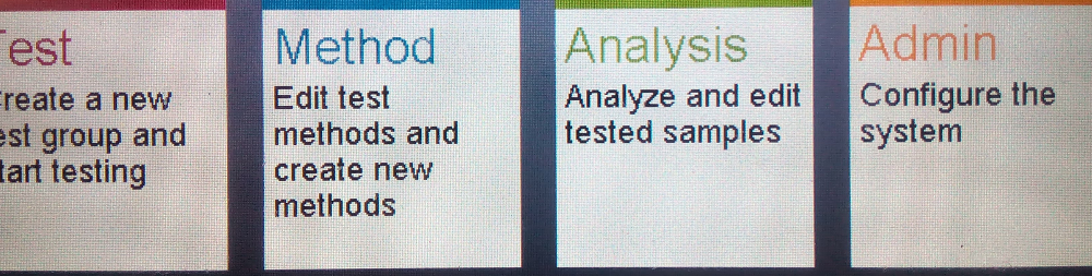

The main problem we have discovered is that the LCD screen shows light blue vertical lines with the same firmware.
We choosen the Alliance memory, because from datasheet they have almost the same characteristics of ESMT, but now we are not so sure that the 2 SDRAM are compatible.
Attached to this post, the timing table e the screenshot of the defect we obtain with new SDRAM.
What's going wrong?
The good image is:
  • Hi Marco,
    Did your board change with Alliance memory chip in any way that affects the capacitance on the traces compared to before?
  • May I note that your "Good Image" reveals less color saturation for both the green and orange colors. (finding 1)
    Your attempt at providing an, "A-B" comparison of images is sub-optimal as the new image fields are "wider" than the old ones.    (90mm vs. 84mm on my monitor - that's > 6% - makes the new image appear bolder!)   (finding 2)
    Note too - there is a clear "regularity" displayed by the slight, blue, vertical bars (new image) - such regularity argues against the finding of "noise."   (may suggest an "address routing issue.")   (finding 3)
    Review of both specs - as you request - can be greatly assisted by   your (first) pre-viewing - and "Highlighting" the differences.      Forcing such high effort upon your remote "helpers" seems outside your best interest.       (i.e. although I've long been successful w/in the display field - I've no taste to perform that "pre-work" for you  -  that's "common courtesy" - is it not?)
    And - as always - no indication is provided as to the number of such "new boards" which reveal this issue.       Single board anomalies hold NO interest (bad solder joint, wrong component etc.) - multi-board issues prove far more interesting, compelling, impacting - thus warrant (much higher) effort & attention...   (especially so when "such issue" strays FAR from the forum's MCU focus - as this (clearly) does!)

    I'll try to reply to your consideration point by point so I cannot make mistake.
    1."May I note that your ...": You should consider that the pictures were taken with a camera and different light sources. So the issue is not saturation.
    2. "your attempt at providing...":  the dimensions of the pictures are not the main concept that I want to show you, but my focus is on vertical lines.
    3. "note too - there is a clear...": this suggestion is quite good, but I've already done a check for addressing issue and I didn't find it.
    4. "Review of both specs...": It's strange that someone who worked a lot on the display field could not find the information in the tables I sent. This is not "common courtesy", but it's just a matter of knowing whether or not to find information in the tables above.
    5. "And as Always - no indication...": I've already filtered this kind of information. We have done a pre series with 'n' boards and all of them suffer of this kind of issue. No other issue like bad soldering, wrong compoment, etc..

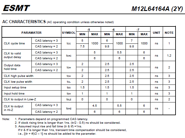

    From the tables is posted above, I've done some consideration but I'd like to share with you before attempt to check capacitance on signals.
    My concern is about row pre-charge time, row cycle time, row active time and clock cycle time. Could these time differences affect the refresh time and create vertical lines on LCD?
    I suppose that there's something related to LCD controller pixel clock (set to 30 MHz) , EPIDividerSet (set to 60 MHz) and refresh time.

      I don't know which version of each memory device you have. I try to compare the widest extreme between the two. The Alliance -7 is somehow slower than ESMT -5. Can you still modify your firmware? Can you play (i.e. adjust timing) with these timing parameters in the EPI to see if it makes a difference?
        Alliance Version -7 ESMT Version -5 unit
        min max min max ns
    row cycle time   63   53   ns
    RAS to CAS delay   21   15   ns
    precharge to refresh/low activate   21   15   ns
    row activate to row activate delay
    (different bank)
      14   10   ns
    row activate to precharge
    (same bank)
      42   38   ns
    write recovery time   2       tck
    CAS to CAS delay   1       ns
    Clock cycle time CL = 2 10   7.5   ns
    Clock cycle time CL = 3 7   5   ns
    Clock high   2.5       ns
    Clock low   2.5       ns
    Access time from CLK CL = 2   6 6   ns
    Access time from CLK CL = 3   5.4 5   ns
    Data output hold   2.5       ns
    Data otuput low impedance   0       ns
    Data output high impedance     5.4     ns
    Data/Address/Control setup time   1.5       ns
    Data/Address/Control hold  time   0.8       ns
    Mode Register set command time   2       tck
    Average refresh interval time     15.6us    64ms
