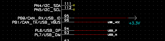

Hello!
We are developing a lab device based on TM4C1294KCPDT, and it works fine, except of USB. I want to connect device to PC with USB CDC driver, emulating serial port. The schematic is very simple - as this is just device, I connected USB_DP, USB_DM, USB_VBUS directly to mini-USB connector, protecting the signals with reverse diodes, and pulled up USB_ID to 3.3v. Pin 1 is VBUS, Pin 2 is USB_DM, Pin 3 is USB_DP and Pin 5 is GND.

  • Hello Oleg,
    It sounds like a custom board so can you provide the schematic for it?
    Was OS are you using? What version of TivaWare?
    Are you seeing an unknown device anywhere in Device manager when the board is plugged such as under USB controllers?
  • Windows 7
    TivaWare_C_Series-2.1.4.178
    No device, even unknown, appears in device manager.
    When I measure voltage on USB plug pins, I see 5V on VBUS and 0V on DP/DM

  • Hello Oleg,
    I don't see any initializations for the USB pins shown in your schematic in what you posted. Can you please verify on your code that you have the USB GPIO's you are using configured correctly?
    Also another check that would be useful is to verify what the result of the SysCtlClockFreqSet function (saved in Clk variable) is to ensure the system clock is running at 120MHz. It sounds like the rest of your firmware is working correctly from your first post, right? If so that at least should rule out startup issues with the 16MHz crystal.
  • Hello!
    I added GPIO initialization to code:
    	SysCtlPeripheralEnable(SYSCTL_PERIPH_USB0);
        HWREG(GPIO_PORTD_BASE + GPIO_O_LOCK) = GPIO_LOCK_KEY;
        HWREG(GPIO_PORTD_BASE + GPIO_O_CR) = 0xff;
    	GPIOPinTypeUSBAnalog(GPIO_PORTB_BASE, GPIO_PIN_0 | GPIO_PIN_1);
    	GPIOPinTypeUSBAnalog(GPIO_PORTL_BASE, GPIO_PIN_6 | GPIO_PIN_7);
    	SysCtlVCOGet(SYSCTL_XTAL_16MHZ, &ui32PLLRate);
    	USBStackModeSet(0, eUSBModeDevice, 0);
    	USBDCDFeatureSet(0, USBLIB_FEATURE_CPUCLK, &Clk);
    	USBDCDFeatureSet(0, USBLIB_FEATURE_USBPLL, &ui32PLLRate);
    	pvDevice = USBDCDCInit(0, &g_sCDCDevice);
    Now device started to connect to Windows, but it appears as "Unknown device" even with default VID/PID pair:
