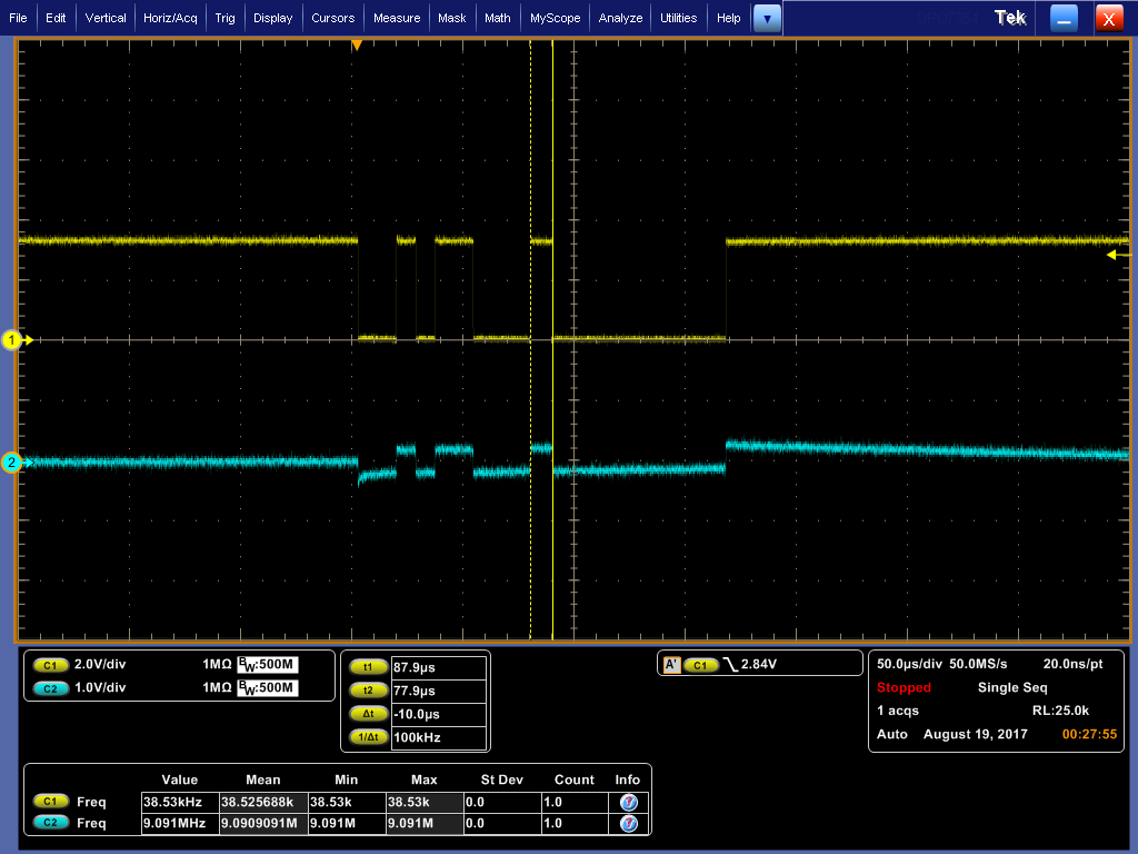

    Now the UARTCharPut no longer hangs and the UART transmits the data out the TX port (scope capture confirms...). However, RealTerm does not show the incoming data. Maybe I don't know how to run RealTerm. However, more troubling, the same bit sequence also appears on the RX pin simultaneously with the TX, but at ~1/4 the V swing.

  • Hi Erik,
    Looking at the scope capture, are the bit times correct? Can you help me understand the hardware? You have PH6 and PH7 attached to an RS232 transceiver and then the RS232 line attached to an RS232 to USB converter/cable? At which point are you seeing the TX waveform on the RX line?
  • HI Bob,
    There is no RS232 xciever between the uC port and the Gearmo GM-TTL3VT USB-TTL RS232 interface. The GM takes care of the level shift.
    It appears the TXD port on the GM is connected to the TXD port on the uC and both sides are xmitting on that pin. So I need to swap the signal wires on the GM connector to alleviate that.
    Re. timing, the scope captures show bit periods ~9usec. The baud is set to 115200 so I think that is ok.
    I don't recall ever seeing a TXD signal appearing on the RXD line (tho here RXD amplitude is 1/8th TXD) on other UART's I've delt with in the past (ch1 =TXD; ch2 =RXD. Note vertical settings 2V vs 1V). This was captured from the header pins on the board (signal from uC), no UART cable attached. It is identical when captured from the GM cable (doesn't change connected to target or not).
    Both interfaces do this (the uC, and the GM cable, whether connected or not). I need to get back on this and do the cable swap and retest. I submitted a query to GM about the TXD/RXD contention to clarify how they define the direction of these two pins (no reply yet). I think the board designer of our board assumed GM's TXD pin corresponds to target's TXD pin (so direction is transmitting to host). However, appears it is the reverse.
    Any ideas why, after power-up, and initialize, I still have to issue a UART disable/enable to get things working (see previous post)? Is this anything to be concerned about?
    Thank you.
  • The RX signal looks like it is just capacitively (or inductively) coupled from the TX line. This implies that nothing is driving the RX line. I would expect the TX from the Gearmo GM-TTL3VT should connect to the RX of the TM4C, but I will let GM clarify that.
