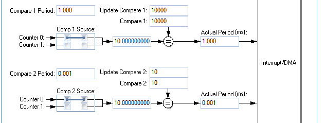

I would like to use RTI module to generate periodic interrupts. With HALCoGen I set the following configuration:
The IT associated with the RTI Compare 1 works perfectly, the handler is called every 1 ms.
But I have an issue with the IT linked with the RTI Compare 2, the handler is called every 7 us instead of every 1 us. Currently, the handler is just about incrementing a counter (to check the period using a breakpoint point in RTI Compare 1 handler) and resetting the Interrupt Flag Register.
Is there any restriction about the frequency of the IT based on RTI module ?
