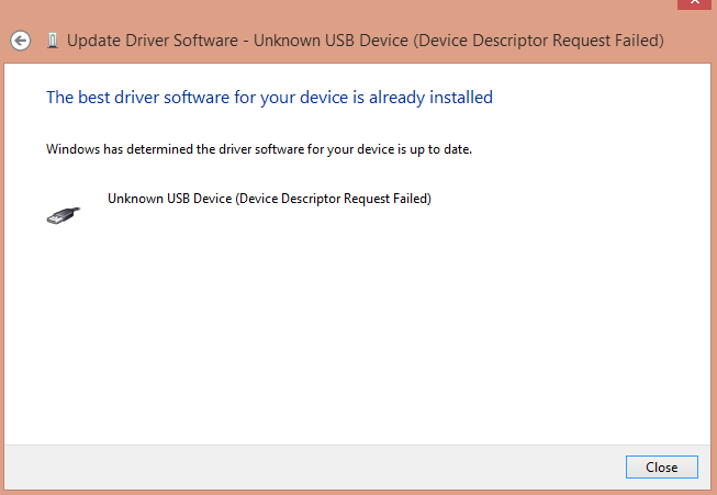

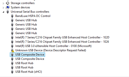

Hello, I'm new to Tiva Microcontrollers.  Recently I bought an EK-TM4C123GXL and tried to connect it to my PC. The USB port detects a connection but does not recognize the device. I'm using Windows 8.1 OS and tried following different steps from some posts in the forum. So far, every attempt has been unsuccessful. The Device Manager only shows one Universal Serial Bus Error. I've tried to install the Stellaris icdi drivers but when I click to update in device manager, I get a notification that says "The best driver for your device is already installed. Unknown USB Device (Device Descriptor Request Failed)". This problem wont let me program the TM4C123GXL as the Microcontroller isn't recognized. Please, need help. Thanks!

  • Thank you for the help Bob. After testing various of the proposed solutions in different posts, and several trial and errors, I have found the solution. The problem is that the supplied USB cable that comes with the TIVA C Microcontroller is defective. I changed the cable and it all got recognized in Device Manager. I tested the connection sending a program to the TM4C123GXL and it worked.
    Solution: Changed the USB cable
