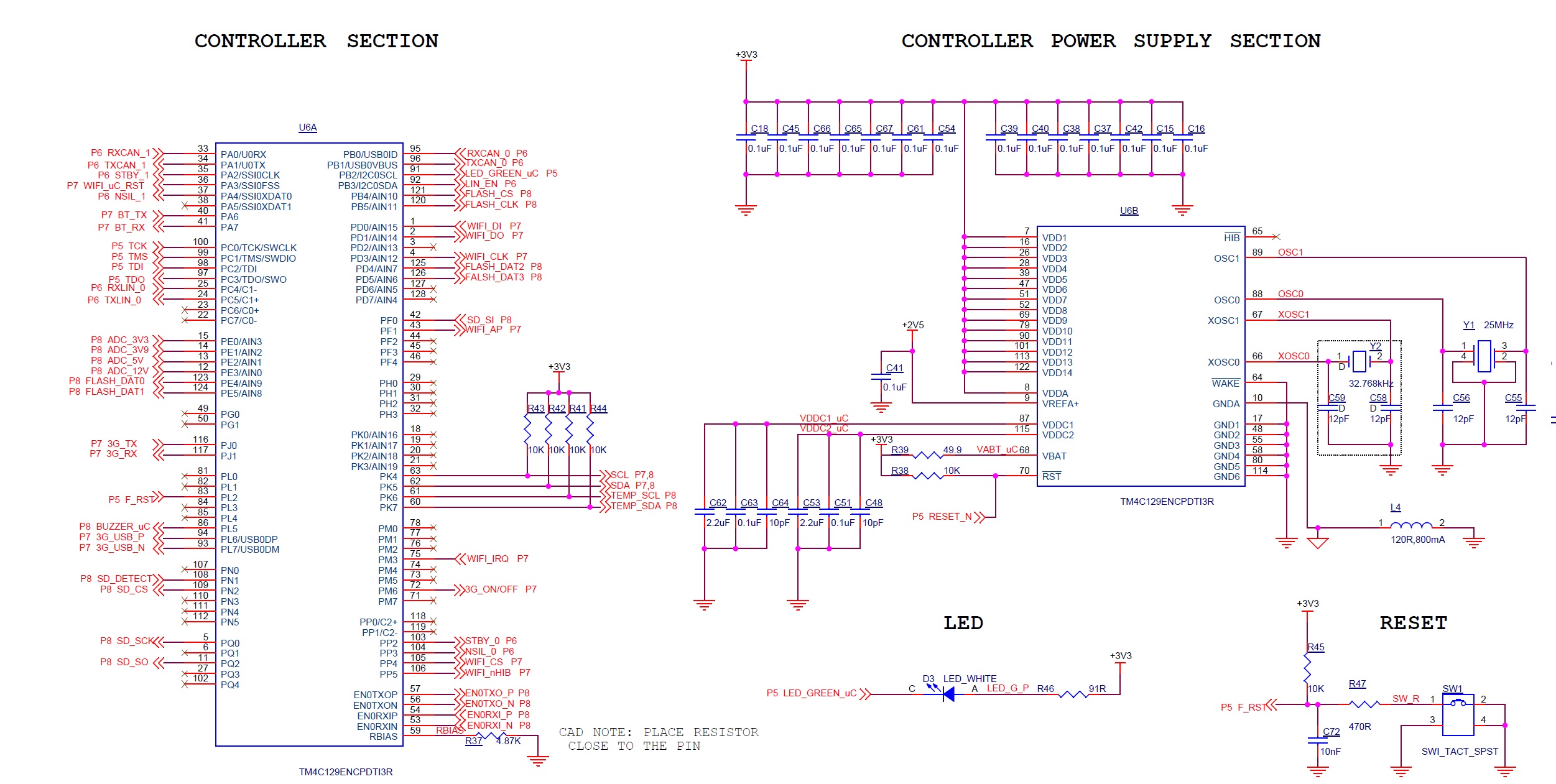

I have the kit "Tiva C Series TM4C1294 Connected LaunchPad" which is used to program our new board containing TM4C129ENCPDT, but when trying to program the MCU it is showing as "Error connecting to the target". When we try to program our old board its working fine with same code.
Am also attaching old and new design here.
Error
New Design (not programming)
Old Design (programmable)
What seems to be the problem here?

  • Feel your pain - such "Failure to Connect" occurs so often, here.     BTW - excellently detailed & presented posting - very well done!
    Both your old & new design - to my eyes - to not include "external pull-up resistors" - which ALWAYS prove helpful. (MCU's internal ones are far too high in value to ALWAYS enable correct JTAG operation - free from rounded signal edges & reflections)
    A superior, multi-vendor (i.e. real) JTAG Probe (i.e. J-Link) also is known for yielding "more robust connections." (the fact that yours "worked once" does not prevent that (past) working from being (then) "marginal" - and (now) inadequate!) Such is reality - low cost "tools" cannot compete against "purpose dedicated ones" - as you/many others - are noting.
    I would check - and compare - the current draw of both boards as well.
    Scope monitoring of the JTAG Signals - first across a "working (old) board" - and then the "failing (new) board" - also is indicated...   (provides the surest "means to correction.")
    Use of a "real/pro/purpose designed JTAG probe" AND inclusion of external pull-up resistors highlights your,  "best path."
    Agreed with cb1 here. Also the JTAG connector is not shown, but it should have a de-spiking cap.

    I don't like your reset circuit, I'd prefer to see a proper supervisor.  That said a lot of people do use that type.
    And as cb1 usually asks. Have you tried multiple boards?

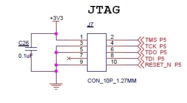

    Below is the JTAG connector, it is similar for both
    Is there any configuration pin for TM4C129E MCU's (pulling up/down pin's causing some problem's)?

    Will probe the signals on both the boards. I tried to program 2 new boards, but same issue exists in both.
    Muhsin
  • Hello Robert,
    Yes i tried two new boards, same issue exists.
    Below is the image for JTAG

  • Greetings - good that you tried additional boards - testing (only) a single board too often "eats" time/energy.
    My friend - your schematic reveals NO external, pull-up resistors!    Relying upon the "too high" value of the MCU's internal resistors is, "High Risk" - and while may work "sometimes" - it cannot be counted upon!   It should not be too hard to (even temporarily) add external pull-ups - and relaunch your test.
    For a more "in-depth" solution (yet still employing external Rs) - visit "Segger's" site - and investigate the "educational discount" they generously provide for the "World's Top Selling (real) JTAG Probe - "J-Link."     The time/effort/development funds of those here cannot be expected to match those of the "J-Link" - AND it is vendor agnostic - you may use ARM MCUs from "ALL Vendors" - not just a "single vendor" hoping to "lock you in."
    Do make the board current measurement - just in case.     Your scope monitor & capture of (both) good board (accepts JTAG) and bad board (i.e. too often - those here) should prove useful...
  • Hello Muhsin,
    Notice issue 25Mhz crystal (Y1) both PCB are missing a (required) series resistor to limit internal oscillator (MOSC) current draw at a safe level. Note only certain crystal & vendor part numbers are proven & supported this MCU as listed in data sheet. Also perhaps causing some other unreported issues the need for an RBIAS resistor (4.87k/1%) even if not using the EMAC PHY0. RBIAS resistor is often required for the ROM boot loader to function correctly on first POR cycle when flash memory is erased.

  • Hello BP101,
    Will try by mounting old crystal's in new board.
    Is the RBIAS resistor really required? anyway will check with mounting a RBIAS resistor.

  • Indeed - that RBIAS IS required - just as BP noted. (he learned that of course from Amit - who guided so many here)
    Having produced well over 7K boards w/this vendor's MCUs - never have we employed the series (xtal circuit) R - mentioned by BP.    Perhaps there is "extra sensitivity" w/in the 129 series - which we've never used!   (as 200MHz+ M4s - w/DACs - and Graphic Accelerators - far more compellingly -  "dot the Cortex-M landscape!")
    It is surprising that your original (old) board "worked" minus that resistor. As (most) always - vendor's (proper) high-light of such vital requirements REMAINS Lacking.    (yet they've "found the time & will" to "Ban the LIKE!")    Delightful misuse of resources...

  • Thank you very much BP, adding RBIAS resistor solves the problem. Now i can program the MCU. But the datasheet mention that resistor is not required when not using PHY.

    Adding RBIAS resistor resolves the issue. The old board have a RBIAS resistor, we are using ethernet PHY on that board. The datasheet mention that RBIAS resistor is not required while not using ethernet. We are not using ethernet on our new board, thats why we didnt mount that resistor.

  • Thank you - glad you resolved - JTAG (or SWD) lock-out - never fun - and happens "far too often here!" (just review the MANY reports of "lock-out!")
    That said - the absence of JTAG pull-up Rs will not serve you well - especially long term. MCU resistors are far too high in value - you may be "marginally performing" now - but: "Aging, Voltage, Temperature change and/or MCU process change" - may again - "Lock you Out!"
    The use of a "real" process-designed JTAG Probe is also (highly) recommended. Low cost (tools?) are NOT your friend - will "cost you" in the long run...
