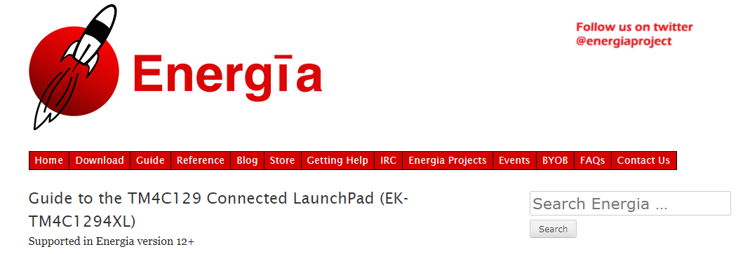

    Besides,I have found some information about TM4C1294 on Energia's homepage,as shown in the figure.
    Does it mean "Embedded Coder Target for Energia" has already supported Simulink example models(like ADC,PWM blocks) for TM4C1294XL currently?
    What's more,Can "Embedded Coder Target for Energia" be used for commercial products?
    Chuang Tao
  • Hi Chuang,
    MathWorks support for Energia is for Release R2015b and later. You can try it with R2015a or R2015aSP1, but I don't think it will work. Beyond the support package, you can MathWorks tools and Embedded Coder to generate ANSI / ISO C code of your algorithm and import that into CCS. It will take work to set-up; but this workflow is what many commercial customers use as the development process for every company is unique.
