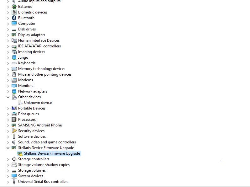

Hi I have the configuration as shown in the attached screenshots. I have been trying to install the ICDI drivers but I have been unable to do so
I have followed this
e2e.ti.com/.../554843
The issue is that I never get anything to display on my device manager
I don't get the message that the drivers are not installed
Any fix for this?

  • I am using Win 10.No I get no pop up when I insert the USB cable.i am using those drivers which were provided on TI website

  • I do not understand your question, the issue is that Windows does not report anything when I plug in the board. Nothing even appears on the device manager. I tried a workaround using Stellaris from the legacy hardware settings but it was of no use. I will try to put in more information later.

  • Hi Ralph, The Green LED does light up. The cable issue I am not sure of, I will see what I can do about that. Regarding Device Manager, that is what I have been saying,it is not appearing either in Device Manager or USB Devices.
  • Hello Nicholas,
    Is the screenshots you posted from your device manager? If so can you install any driver software for this?
    I'm not sure where those device manager shots are coming from but it didn't seem to be from our app note...
  • Hi I tried the application note, but I was not able to see any devices under the Other Devices. Also this Stellaris which you have shown in the screenshot that is from the Add Legacy Hardware option in the Device Manager. Whenever I try to update the device software for the shown screenshot WIndows responds saying the software is up to date. however this is not true, because Keil cannot detect the device.

    Another possibility could be to uninstall/delete the TI drivers completely and then try to re-install them? I don't know why there is a "Stellaris Device Firmware Upgrade" option in your device manager - haven't seen that before - so maybe a step like that could help remove that and get the drivers correctly installed.
  • Hi Ralph,
    My problem is solved. It was a very silly misconfiguration,but I would have never looked into it if it hadn't been your help. I will explain it
    So there are 2 ports to connect the USB cable to the board DEVICE and DEBUG . All this time I had connected the cable to the DEVICE port , so it was not detecting the drivers. I changed the cable to the DEBUG port and voila everything worked perfectly and I was able to install the drivers. Thanks a lot Ralph.
