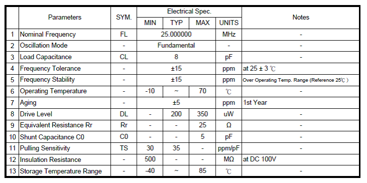

Customer running with 25MHz Crystal and trying to determine it's impact TM4C1290NCPDT PLL stability/drift and how it impacts CAN Controller to answer the following:
For PLL's record max drift. If a PLL is being used record tolerance of the PLL and base oscillator
with a 25MHz crystal with the following specification
They are worried that based on their calculation there is a 1% drift which violates the CAN protocol of +/- 0.4% at 500K CAN.  The  PLL is configured for 480MHz, M = 96, N = 5, reference frequency 5MHz

  • Hi Lawrence,
    Are they referring to this paragraph on page 1579 of the datasheet?
    If the main oscillator provides the clock reference to the PLL, the translation provided by hardware
    and used to program the PLL is available for software in the PLL Frequency n (PLLFREQn) registers
    (see page 285). The internal translation provides a translation within ± 1% of the targeted PLL VCO
    frequency. Table 5-7 on page 231 shows the actual PLL frequency and error for a given crystal
    choice.
    This is not a drift specification. When the PLL is locked, it is constantly adjusting to the oscillator source it is locked to. The overall drift is the drift of the oscillator source. The PLL jitter is actually averaged out over the time of a single CAN bit.
    The statement above is confusing in that it talks about a translation error, but table 5-7 shows only crystal values where the translation error is zero.

  • A translation error is dependent on the crystal value.
  • Manual said:
    If the main oscillator provides the clock reference to the PLL, the translation provided by hardware and used to program the PLL is available for software in the PLL Frequency n (PLLFREQn) registers (see page 285). The internal translation provides a translation within ± 1% of the targeted PLL VCO frequency. Table 5-7 on page 231 shows the actual PLL frequency and error for a given crystal choice.
    So this is not a drift but a fixed error. Presumably because of integer divide limitations. I think what you are after is jitter. Specifically the accumulated jitter over a fraction of a bit time. Unfortunately I don't see jitter documented.
