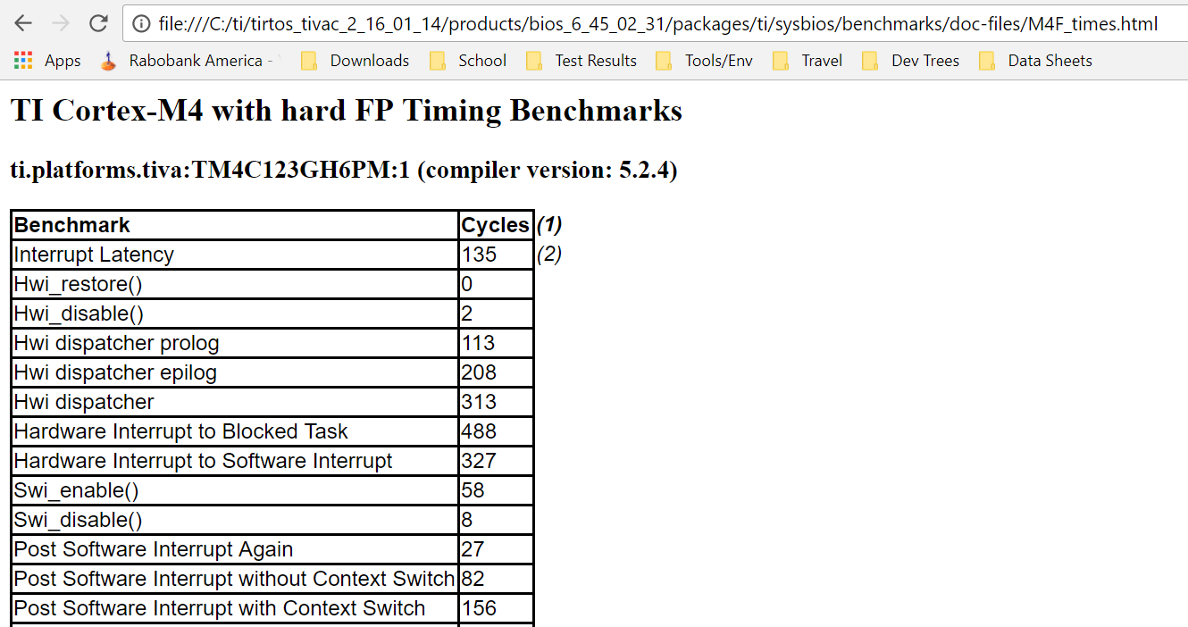

  • Probably easiest to just point you to the code in C:\ti\tirtos_tivac_2_16_01_14\products\bios_6_45_02_31\packages\ti\sysbios\family\arm\m3\Hwi_asm.sv7M. This is one of the few places we use assembly for performance reasons.
    We also publish timing and sizing benchmarks. Look at the Docs Overview html page (file:///C:/ti/tirtos_tivac_2_16_01_14/docs/Documentation_Overview_tivac.html) and go into the kernel's release notes. There you'll find a timing and sizing benchmark link. We have all the sizing and footprint values for all the devices we support here (e.g. M4F with TI compiler). For example:
    The Kernel's User Guide (link in the Docs Overview page also) talks about these values in more detail.
    Todd
