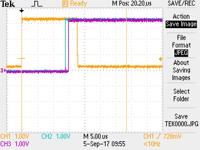

Hi all,
I am trying to modify a custom board utilizing the TM4C1294NCPDT microcontroller to create trigger source/fan out. The goal of the board is to receive a trigger signal, causing multiple timers (ideally all 6) to start counting which then outputs a signal when they timeout (counter values are updated through an HTTP POST request, therefore a running Ethernet routine in the background).
Software use:
  1. Code Composer Studio 7.1.10
  2. LM Flash Programmer
Hardware use:
  1. EK-TM4C1294XL (debug portion as the debugger/programmer)
  2. Tektronix TDS 2024C Oscilloscope (felt the need to mention this)
As mentioned above, timers start counting when the user triggers (rising edge input) the board, the purpose of the timers is to create a delay before triggering their respective devices. Right now, I'm attempting to put a 10 us delay in both Timer 4 and Timer 5 using PIOSC as my peripheral clock with no success (where success means that I trigger my devices with a 10 us delay, with little error as possible). The output of my board with the most current code is as follows:
  • Above image is the output of the board, where yellow is the triggering trace
  • The user triggers the LED (rising edge) and Timer 5 (Purple trace) interrupt service routine will turn it off (falling edge) prior to clearing interrupt flag.
  • Blue and purple trace are timer 4 and timer 5 ISR respectively.
  • The trigger trace is 13.40 us wide (from trigger signal to purple ISR routine), blue trace is 600 ns past the falling edge of the trigger (turns on 4 us later than intended), and purple is 1.8 us past the falling edge of the trigger (turns on 5.2 us later than intended).
  • Cursors (dashed yellow lines) in the above image is 10 us wide to show the discrepancy of the time elapsed to entering the ISR.

I suppose my question would be - is a 5 us delay even attainable on the timers with an Ethernet Routine running in the background?
Stephen B.
I can post more pictures if it helps - I am avoiding making this too lengthy.

  • Before I reply to any of the above comments, I must deeply apologize for my lack of contact for the past 5 days.
    cb1_mobile said:
    As your time frames are (relatively) short - and you employed two 16-bit Timers (i.e. split timers) would not your Timer Configure Parameters: "TIMER_CFG_PERIODIC"
    be better served via the (more proper) parameter: "TIMER_CFG_A_PERIODIC"?    (which is intended for "Half-Width" Timers)     The parameter you employed targets "Full-Width" Timers.
    Yes, prior to facing this issue, I did attempt the use of Half-Width Timers which, I admit, made more sense and was a far more efficient use of the device. However, at the time I had also implemented Half-Width Timers, with the use of TIMER_CLOCK_SYSTEM (at 120 MHz) as a source, which I had difficulty implementing with a 16-bit timer and prescalar for under 50 us. I figured that I had spent enough time on it, that an attempt at a different method (use of a Full-Wdth Timer) was due. Additionally, a slower system clock could easily have been configured to accommodate but was wary (for lack of justification) of how it will affect Ethernet routines.
    Yet, now with the use of TIMER_CLOCK_PIOSC (at 16 MHz) as a timer source, I realize that I should be able to use Half-Width Timers once more without the need to mess with prescalar (and update the code I shall - after this post. At the very least for comparison and knowledge "level-up").

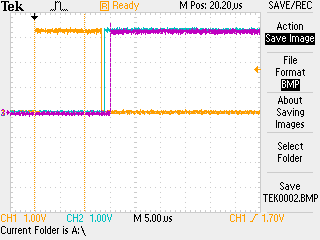

    Applying "KISS" (which I did not reject); I removed all the Ethernet routines (and related code) and removed some conditional statements in the timer ISR to reduce time (maybe?) to reduce the amount of "gears" that could cause (potential) errors (applying age-old knowledge that the more gears in a plan have more points of failure).
    This resulted in a curious case where the my LED is turning off after both timers have turned on, despite turning off the LED is the first instruction in the Timer 4 ISR.
    Changing the timer delay value for Timer 5 (purple trace) yields a longer delay as expected, but the LED (yellow trace) stays in the same relative space.
    Apologies cb1_mobile, there were no options to save the images as .png, and instead, I had opted for the .jpeg.

  • Glad you've returned - thanks for your in-depth (and accepting) reply.
    Your new scope caps are larger (easier to read) yet it appears the recent (unwanted) claimed forum "upgrade" has "done away w/the ability to "blow up the image - when opened  in a new tab."    Still - these caps are superior.
    Does it not make sense to (temporarily) employ just one, half-width MCU Timer - and create your 5µS "pulse or delay?"    That serves as a "building block/foundation" - upon which your subsequent efforts land.    Syncing the timers has proved challenging to many - and has fallen victim to errata (be sure to check) - I'd (thus) ask if that's (truly) required by your application.
    Prioritizing your interrupts deserves your attention & "scope monitored" experimentation.     A newly arriving (higher priority) interrupt (nicely) "kicks a lower priority, executing interrupt" - to the curb.    (lower priority "sits/waits" - until the higher priority executes & completes!)
    Again it appears these are tasks before you:
    • create a single Timer pulse/delay meeting your 5µS spec   (proves that you - and the MCU can (surely) achieve that
    • assign different Timer Interrupt priorities
    • launch a lower priority interrupt - then while it is executing - launch the higher one (and note the higher priority "taking charge").     You may toggle a different GPIO from w/in each Timer Interrupt - which provides a clear & effective means to confirm entry into - and exit from - each unique interrupt
    • lastly - attempt to "chain Timer interrupts" but (only) after solid read & understanding of MCU errata in that specific, "Timer Chained/Interlocked" regard.
    Absences are expected - yet the (responding) guidance given (should) be adopted...    (shows (some) care/concern for your unpaid/overworked/now "LIKE-less" helper crüe...)     We DO look "damn good" in our "low thread count" - vendor supplied - T shirts ... that's for sure...
