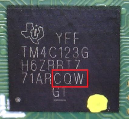

According to customer feedback, they want to know Line4 internal tracking code meaning. Because they found out they got some TM4C123BH6ZRB chip didn't work properly with same program method. They found the difference between work and didn't work IC is Line4 internal tracking code. Please see below picture.
 Could you please help to check what is the meaning for internal tracking code? thanks!

      There is also difference in "74C2" vs "71AR" in the marking. I will find out and get back with you.
  • Hi Lisa,
    You can refer to the section A.3 Device Markings in the datasheet for more details. The fourth line will have the form of YMLLLS. The YM indicates the year and month of the manufactured unit. The LLLS is what we call the Lot Trace Code (LTC). With the LTC, we can trace back which wafer fab lot and wafer the die is from.

    Customer will write data into EEPROM after power up device They found out EEPROM data isn't right when first time power up. But after they re-program MCU and EEPORM data is right.... However, they use the same factory image and bring up method. There is no problem in another units. The only difference between M4 is date code. That's why they want to know the meaning of date code. Have you ever heard any issue on those specific date code M4 unit ? thanks!
