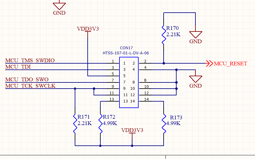

I'm using the TM4C129 in my board who is based on EK-TM4C129EXL. I'm using the interface XDS100V2 to program.
When I load the firmware, it starts running correctly, but when I power cycle the board, the firmware is lost.
When I load the same firmware in Launchpad, it is not lost.
Can i have some help with this, please?

    It is not all 'F'. I can see the firmware now in Memory Browse. After some tests, I have more info.
    The firmware is running just with the debugger connected. When I disconnect the debugger and power cycle, the firmware don't run. If I connect the debugger again, the firmware start running.
    I can't run the mcu standalone.
  • I was going to suggest such, "Test w/debugger (remaining) on/connected."
    Often this signals that MCU reset pin - (on your custom board) is not properly managed by your pcb layout.    The debugger supplies proper "reset pin" management.
    Also - all custom boards do best w/external pull-up Rs placed at JTAG pins & MCU Reset.    (this also provided by debugger's attachment)
    Does this (same) failure occur on, "More than one custom board?"    That's important - each/every "new" custom board contains "infinite suspects" - testing "just one" gravely limits the diagnostic process...    (i.e. welcomes dreaded, "Single Board Anomaly!")   (i.e. bad solder joint, solder short, improper component value etc.)

  • Thank you - glad that you followed the "pull-up R suggestions" I provided."    (see line below - this the first answering post, 01 Sept '17 @ 08:08)
    "Also - all custom boards do best w/external pull-up Rs placed at JTAG pins & MCU Reset.    (this also provided by debugger's attachment)"
    Note that your R170 (2.21K) between Reset & Gnd - will "HOLD your MCU in Reset" - (assuming you employed 4K7 - 10K R as Reset pull-up.)
    It is suspected that you (removed) R170 - while insuring that Reset IS pulled up... Would you be so good as to confirm?    (your issue was assumed to be hardware due to the (claimed identical) SW running well on a similar board)
  • Yes, I removed R170 in initial tests, but doesn't work!
    I need to change all the circuit.
  • You need a 10K pull-up on MCU's Reset!   (small cap from Reset to Gnd also helps)
    It could not hurt to add similar pull-ups to your JTAG pins - as well...    MCU's (internal) pull-ups are TOO HIGH in value - not to be trusted...
  • Hi cb1, we have a 10k pullup on microcontroller reset, like in launchpad schematic.
    I agree with you about the resistors, but i'm not the hardware designer. We learn with this mistake.
  • I wish you well.   Beware of HW guy's desire to save 0.20 (USD) by using MCU's (internal) pull-ups.
    Time the SW & Development team then "WASTES" - costs many multiples of any "HW Savings."     ALL costs must be considered!
