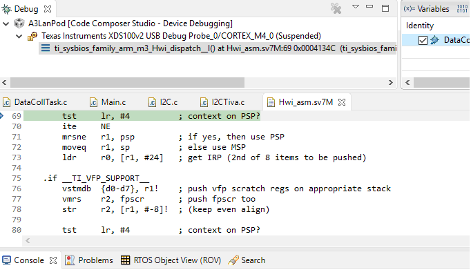

    And when I uncheck both boxes and step, I end up here:
    Is there something here that I should be seeing as a clue?
  • Sorry, the capture didn't past right last time.  Here is where i end up when I try to step while having those boxes unchecked:

    The debugger single stepping setting advice given is correct when stepping through code that may block and then asynchronously start again. You should not disable interrupts while single stepping in that case. To work around that, you should be able to explicitly set a breakpoint at the next line you want to break at and then run to it. If you never arrive at that location, but instead find yourself always in the interrupt dispatcher, then I would suspect there's an interrupt firing that is either not being serviced properly (meaning that it remains active even after the ISR code has run), or that the interrupt is repeating at such a high rate that the background thread is never being returned to.
    If you have ROV working in your CCS debug session, the Detailed 'Hwi' view will show you which interrupt is currently being serviced (it will be tagged as "Enabled/Active") when you halt the application.
    If you don't have ROV working, you can use the debugger's register view to determine the number of the interrupt being serviced. It is contained in the least significant 8 bits of the xPSR register (ie the EXCEPTION field).
    In this case, knowing the interrupt number being serviced will help identify the issue.

    I'm not clear on what you mean when you say "To work around that". Do you mean to avoid stepping down into asm when ints are enabled and I'm stepping over the function? If I have to set a breakpoint after the line I want to step over and Run to it anyway, I guess it really doesn't matter whether I leave that box checked or unchecked. No?
    When my code blows up on a step through (when ints are disabled when stepping), I believe ROV told me that int #3 is active, and int 14 is pending.
    When I uncheck that box to leave the ints enabled and try to step over the function, it was automatically stepping down into asm as I noted before. But I just tried something else that maybe explains it: When I unplug the ethernet cable, it steps over it just fine. (again, this is with ints left enabled.)
    So maybe that's just the Ethernet MAC interrupt I'm seeing in that particular case. Does that make sense?

    I saw your earlier post but got bogged down and forgot to reply to it. Yes, by "work around that" I meant the problem of stepping into ISR code rather than the next line of C code you were trying to step to. You have to uncheck the box to force the debugger NOT to disable interrupts while single stepping. I would expect the debugger not to disable interrupts when 'running' to a breakpoint.  Curiously though, the problem you're seeing has been being reported a lot recently even though no change has been made in the underlying code that requires interrupts to be enabled while stepping for over 8 years...
    With the boxes unchecked, if an interrupt fires while the debugger is paused, the next step will go into the ISR code rather than the next line of C or ASM code you were stepping through. By unplugging the ethernet cable, I suspect all you've done is suppress the troublesome interrupt, thus allowing your single stepping to proceed without interrupts.
