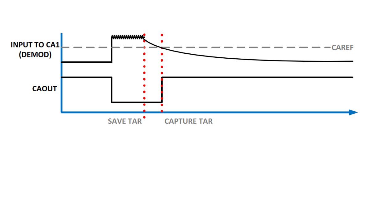

Hi there,
I am trying to use tm41294NCPDT Internal analogue Comparator
I am trying to implement Low Power NFC/RFID Card detection Algorithm
what it does i charge the RC circuit which then discharges and through NFC antenna i read the voltage as soon as it goes down below threshold which in my case i am using 1.65 V (TEST CASE) comparator should generate interrupt
i want to generate following output from Comparator0 using C0+ pin
1:- but the problem is that it triggers interrupt at rising as well as falling edge moreover sometimes it generates interrupt once as soon as the interrupts are configured
2:- I was watching the registers during debugging in IAR and i noticed that instead of comparator 0 register comparator 1 registers are also updating(COMPACSTAT1) but i haven't configured comparator 1
3:- But my main priority is to generate the out put first as shown in figure then trigger an interrupt when comparator output goes back to 1 means interrupt on rising edge

  • THIS is the reference signal diagram
  • I ant to feed the CO+ pin of the comparater and wait for it to go go below reference voltage upon that generate an interrupt and furthur do my task
  • Have you verified with an oscilloscope that there is no noise on the comparator input that triggers a falling edge when the voltage is rising?
  • I am using the 3 volt output from the board also i have tried using a pin (switching)
    i dont think think that noise is going to be an issue here , isn't it ?
  • Also Can you please make sure that i have the configurations right for my specific case ?
  • Is it possible to use -ve input of comparator as an internal  reference and read data from the positive input

  • Hello Tayyab and cb1,
    The application for the NFC ULP card detection only uses a single comparator pin and relies on the Internal reference. Whether this design is perfect is up for debate, but it was certainly possible to be made functional to the extent of meeting application criteria with a single comparator pin and using internal reference when done on an MSP430 so the method is valid at least in that application.
    That said, this application was never tried on TM4C. So whether a single comparator pin is sufficient for TM4C devices is unknown. I would like to assume that it should be fine, but you know what they say about assuming...
    Tayyab, you may want to compare the capabilities of the TM4C comparator and the MSP430F2370 comparator and ensure that the TM4C comparator can meet the requirements outlined in the app note.
    The firmware for the ULP Detection method can be found in the front page of the app note: www.ti.com/.../sloa184.pdf
