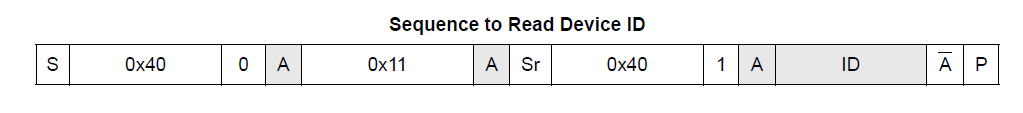

Hi all,
I'm trying to run a simple example for I2C5 on Tiva. I want to read one byte from SI7005. In datasheet, I have this description to read the register.
I started from loopback example in Tivaware and it works fine. Also, after change the source code I can see the SCL and SDA signals on oscilloscope as expected.
I'm using 400kbps for I2C clock and I have external pull-up resistors in SDA and SCL.
I can see only 0 in Watch Expressions when I try to read this register.
There is something wrong with the code?
I'm not understanding the configuration of this peripheral?
Or, is it more likely to be a hardware issue?
The code is attached.

  • Hello Allef,
    Looking over your code, I don't think you need to do a I2CMasterSlaveAddrSet(I2C5_BASE, device_address, true); after you send the address/register data.
    You also should get data with the I2CMasterDataGet API such as: pui32DataRx[ui32Index] = I2CMasterDataGet(I2C5_BASE);
    There is likely more that needs to be done to figure out the issue, but that stood out initially.
    For debugging I would suggest since you are able to see the SCL/SDA signals on the oscilloscope that you look at the communication being sent to the SI7005 device and compare it to what is suggested in the device datasheet.
    Make sure that you are getting the 0x40 and 0x11 being sent, and then see if any bytes are being received and what values they are. If address and data byte appears on the I2C line, but not in the TM4C, then you can debug what is occurring with your receive. If the data isn't being transmitted correctly, then part of your transmission process got messed up, and if the data is being transmitted but no reply is coming, then it could be a hardware, packet framing, or timing issue.

  • Hi, Ralph!
    There is an old group in Google Groups from TI in Brazil. I have the response from a member in this group who has had problems with I2C in Tiva before.
    Just add a delay before:
    while(I2CMasterBusy(I2C5_BASE));
    And change this line:
    I2CMasterControl(I2C5_BASE, I2C_MASTER_CMD_SINGLE_SEND);
    For this line:
    I2CMasterControl(I2C5_BASE, I2C_MASTER_CMD_BURST_SEND_START);
    And now I can get data from this register.
    Thank you very much!
