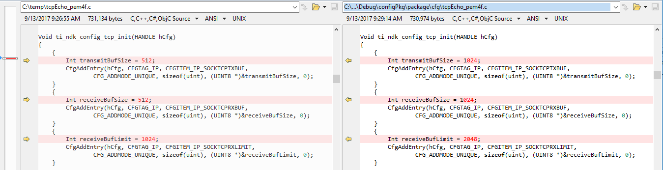

We don't need so large buffers in TCP stuck and we reduced transmit&receive buffers size in TCP&UDP module configuration :
 Tcp.transmitBufSize = 512;
Tcp.receiveBufSize = 512;
Udp.receiveBufSize = 1024;
and minimumSendBytes = 1024 in IP configuration:
So new configuration looks:
Global.lowTaskStackSize = 1024;
Global.normTaskStackSize = 1024;
Global.highTaskStackSize = 1024;
Tcp.receiveBufLimit = 1024;
Ip.socketBufMinTxSize = 1024;
But after build the program its SRAM size is not changed.
What is the reason of it? it seems that we did something wrong...
