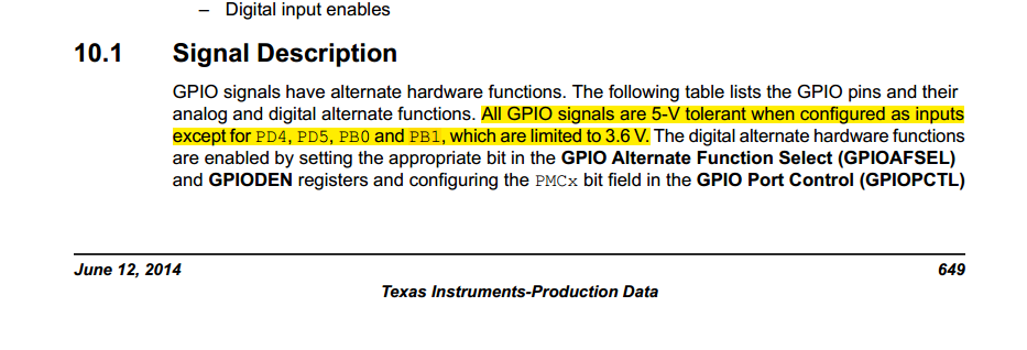

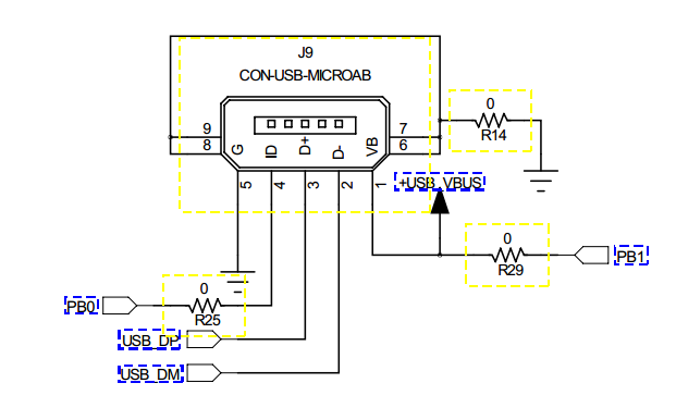

I have configured in the MCU the USB in device mode, I have the following doubt. According to data sheet PB1 / USB0VBUS it is + 5V not tolerant, but on the schematic page it is connected directly to VBUS of the USB connector (+ 5V). So I have two alternatives:
1) Disable VBUS monitoring (eUSBModeForceDevice) and sense the VBUS with another 5V tolerant pin.
2) Activate the VBUS monitoring (eUSBModeDevice) send PB1 to + 5V. In this case I would like to know what I recommend and how it would be the schematic from the pin to the USB connector, ie how to protect the pin from the current and the +5V.
Thanks and regards!
